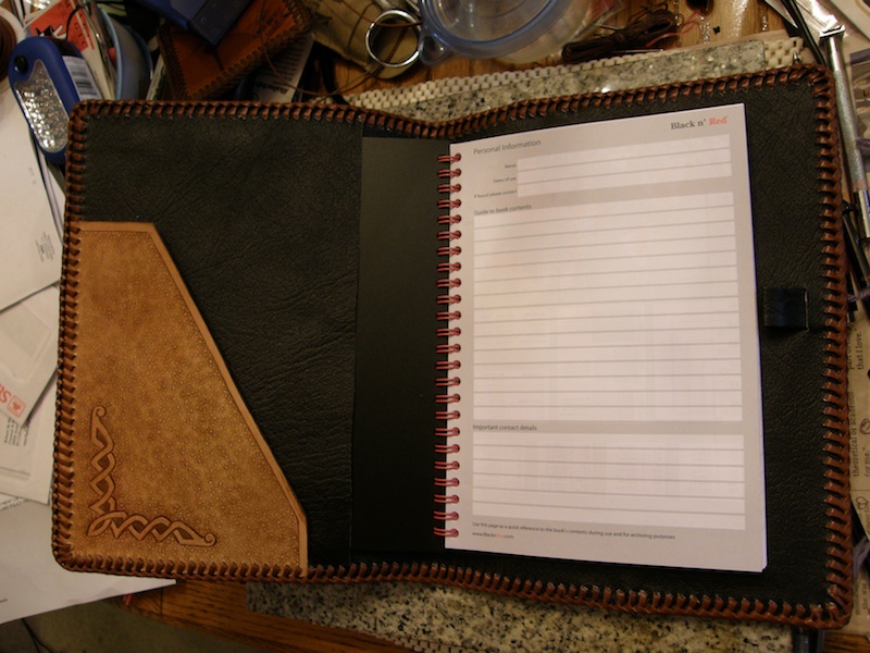

Contributing Member Bob Blea Posted July 31, 2013 Contributing Member Report Posted July 31, 2013 Hi Daniele, I found a picture of a day planner that had 2 oz. pockets installed in it. The pockets are layered on top of one another and skived at the bottom (out of view) to reduce thickness. They are just glued at the bottom to each other but they are sewn along the side where they are visible. This pocket assembly came out kind of bulky in my opinion, and I would probably try to use something thinner (like a chrome tanned leather or the pigskin with a rolled edge) next time if I make something similar to this. I have carved leather this thin but it is very tricky. It is very easy to cut too deep with the swivel knife and end up punching a hole in the leather with a beveler. The pocket below was cut and beveled as you normally would. However, I tried this again on a different notebook and broke through the leather while beveling. Now I just trace the celtic knot design onto the leather and then bevel it without using a swivel knife. I think that so much of leather's strength is contained in the grain surface of the leather that on these very thin leathers I don't want to actually cut through that surface, so I just bevel or use a modeling spoon. However, if you are just planning on stamping the surface I think you will be OK as long as you have it attached to some sort of backing to prevent stretch. In the pocket picture I have used a pebbled backgrounder across the whole surface. It's a big tool that you have to hit hard, and the leather stood up to it just fine. Hope this helps, Bob Quote There are always possibilities.... Bob Blea C and B Leathercrafts Fort Collins, CO Visit my shop at http://www.etsy.com/shop/CandBLeather?ref=si_shop Instagram @bobbleacandbleather
