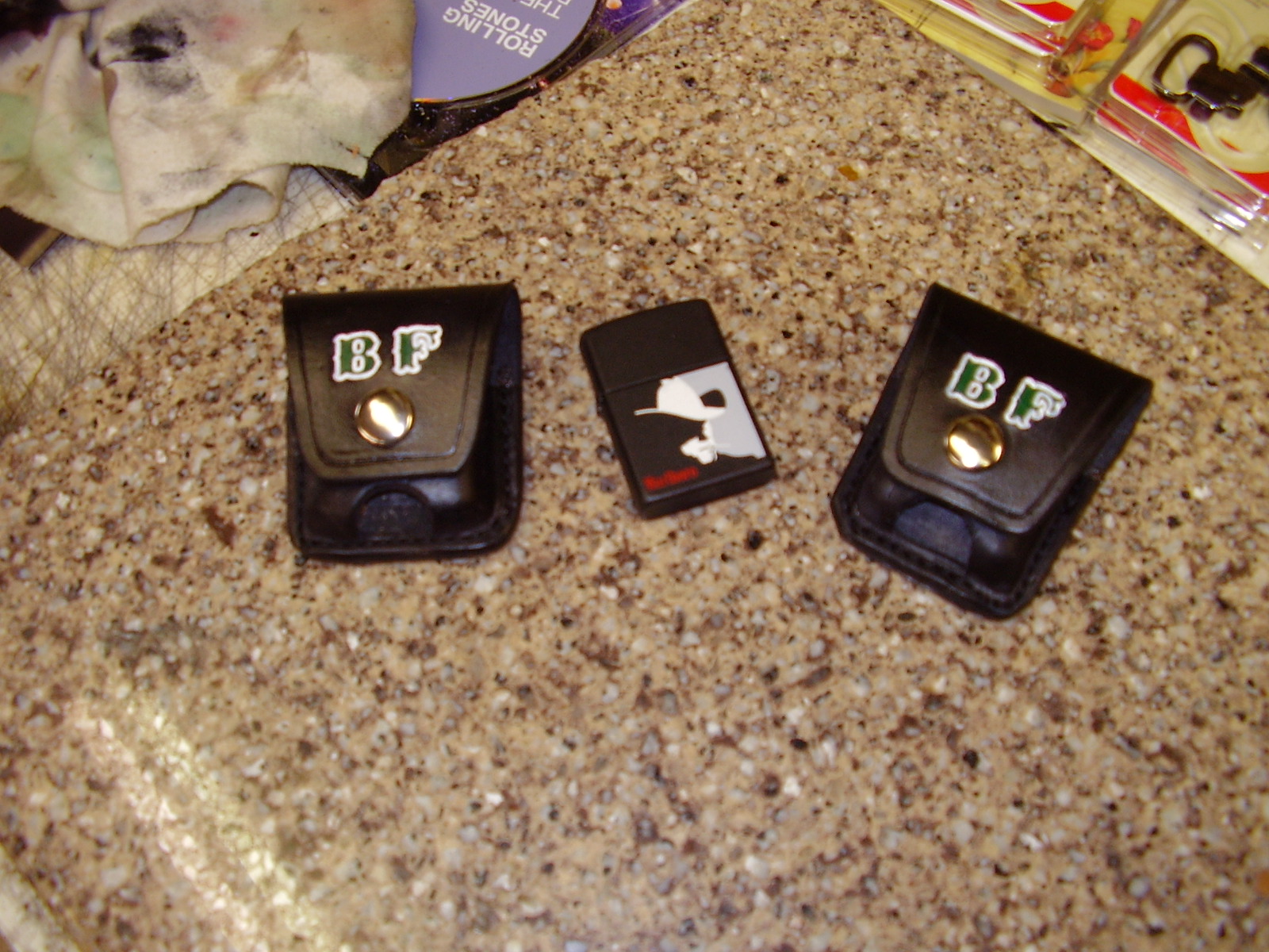

Luke Hatley Report post Posted September 12, 2008 RAY CAN YOU POST A PHOTO OF WHAT YOU DID. THIS IS MY WHITE ANTIQUE FOR OUTLINING LETTERS. Quote Share this post Link to post Share on other sites
