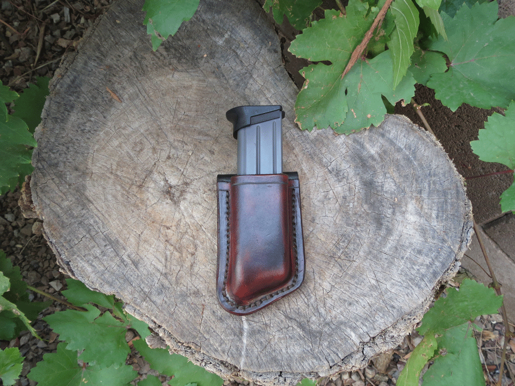

Members vaalpens Posted August 22, 2013 Author Members Report Posted August 22, 2013 Nice little holster there... just be careful. It can be a very addicting hobby, enjoy. Thanks for the nice comments. It is addicting but also very rewarding. I am already working on my next project which will be a matching magazine pouch. Making a mag pouch seems very simple, but I have realized that the forming part and the stitching location needs to be spot on for a decent result. So I am taking my time a bit to make sure I know exactly how I want to approach the project. Quote
Members Dwight Posted August 23, 2013 Members Report Posted August 23, 2013 Vaalpens, . . . most of us have patterns that over time we have adjusted in such a manner that we can predict with serious accuracy where the stitch line needs to go. When we don't have that pattern, . . . we are forced to "form first - then stitch". I also do that to every gun holster that I don't have a really good pattern for. Stitching first is a shot in the dark, . . . that usually is not to my standards. Try forming it first, . . . letting it dry, . . . testing the fit, . . . then stitching. May God bless, Dwight Quote If you can breathe, . . . thank God. If you can read, . . . thank a teacher. If you are reading this in English, . . . thank a veteran. www.dwightsgunleather.com
Members vaalpens Posted August 23, 2013 Author Members Report Posted August 23, 2013 Vaalpens, . . . most of us have patterns that over time we have adjusted in such a manner that we can predict with serious accuracy where the stitch line needs to go. When we don't have that pattern, . . . we are forced to "form first - then stitch". I also do that to every gun holster that I don't have a really good pattern for. Stitching first is a shot in the dark, . . . that usually is not to my standards. Try forming it first, . . . letting it dry, . . . testing the fit, . . . then stitching. May God bless, Dwight Dwight, Thanks for the great information. My holster was stitch first and then form, which was a shot in the dark like you stated. My first mag pouch will definitely be form first and then stitch. The only thing I need to decide now is if I want to apply the dye before or after the form. The holster dye was applied before the forming process. Quote
Members jessebeckham Posted August 23, 2013 Members Report Posted August 23, 2013 I would say dye after wet forming. IUf you are using water based dyes, Like most, then that will prevent the dye from running. I usually, layout, mold, dye, then stitch. I stitch last because I like a good clean white stitch. Quote
Members vaalpens Posted August 23, 2013 Author Members Report Posted August 23, 2013 (edited) I would say dye after wet forming. IUf you are using water based dyes, Like most, then that will prevent the dye from running. I usually, layout, mold, dye, then stitch. I stitch last because I like a good clean white stitch. I am using the alcohol-based dye and there was a little bit of bleeding when I did the wet forming. I think you helped making up my mind to mold and then dye. This will also be a learning experience and will show me if their is any difference in the color between mold then dye, or dye then mold. The stitching after dye makes sense especially if you want to show some contrast between the thread and leather color. Thanks for the good advise! Edited August 23, 2013 by vaalpens Quote
Members jessebeckham Posted August 23, 2013 Members Report Posted August 23, 2013 Remember that's just how I do it, others may have different/better processes... Be sure and keep us updated! Quote

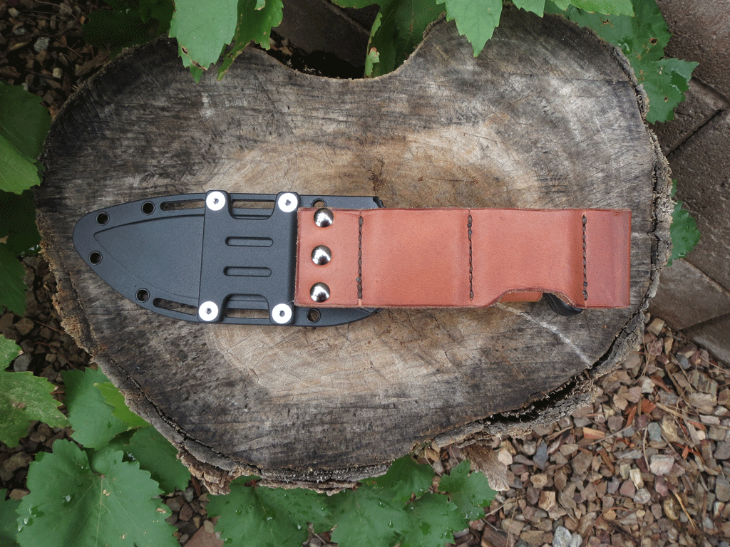

Members vaalpens Posted August 27, 2013 Author Members Report Posted August 27, 2013 (edited) I have finished the second project and did a few things differently: Formed then stitched Formed then dyed Burnish the edges before applying the dye to the edges Wet with brush before using overstitcher Lessons learned from doing it differently: I could not use my groover after the forming since there was not enough space Seems like the color is a bit lighter if you dye after forming, but it could also be that I used less dye It seems that the edges looked better if you burnish before dye instead of after the dye Wetting before using overstitcher seems to work better. You can control it better with the leather being soft. Following are some pictures: Edited August 27, 2013 by vaalpens Quote
