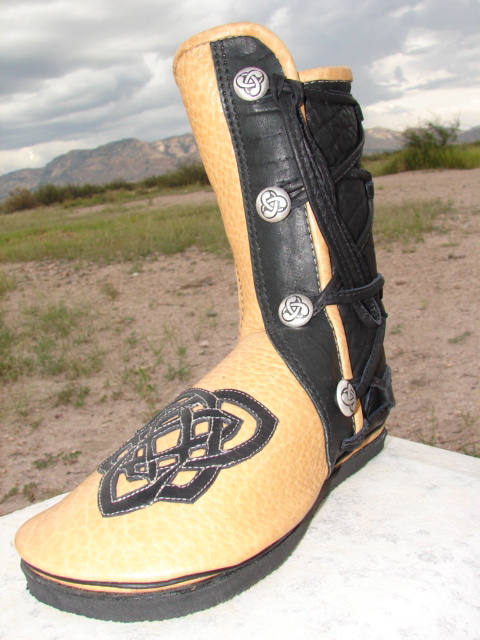

Members SkullCanyon Posted August 25, 2013 Members Report Posted August 25, 2013 Some more moccasins fresh off the bench......... made from scratch everyday. Quote

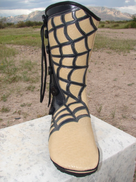

Members wxp Posted November 11, 2013 Members Report Posted November 11, 2013 Very nice, did you hand cut the web? What did you use for the bottom sole ? Quote
Members SkullCanyon Posted November 14, 2013 Author Members Report Posted November 14, 2013 Thanks everyone, The spider web was cut by hand and I usually put some form of Vibram on for a sole. No tutorial in the near future although I will teach a 7 day workshop in my home based shop. The inside seam is skived with a bell knife skiver and over lapped 5/8", then glued and stitched. This looks neater and also removes any excessive leather build up which you would feel. These mocs are mostly made from soft 8/9 oz buffalo and fit like a leather stocking. Very comfortable and form fitted. Kenny............ Quote
