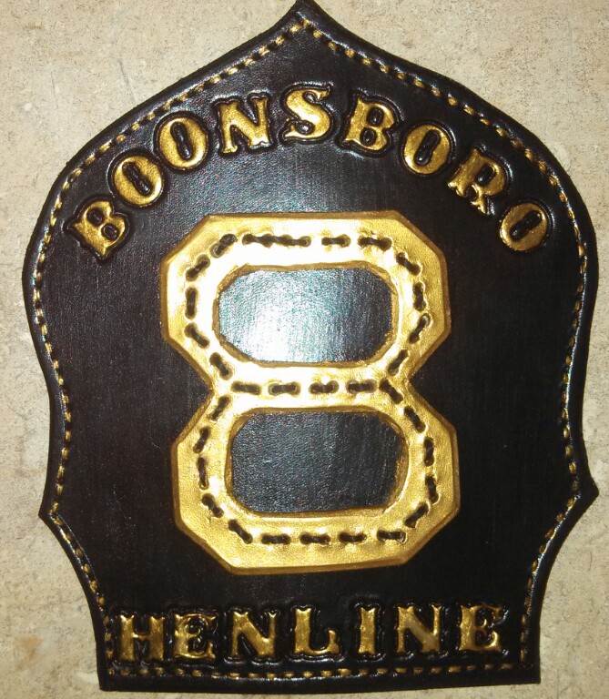

Members engtrk Posted August 26, 2013 Author Members Report Posted August 26, 2013 Thank you all for the responses! There are a few things I will be trying now. Rivercity- he likes the look of painted on "stitching", plus he wants it in gold and I do not have gold thread. See my example pics below. The first on is painted gold thread, the second is actual stitching in black. Quote http://leatherfire.com Custom leather fire helmet shields Henline Leather FB
Members Les No6 Posted August 26, 2013 Members Report Posted August 26, 2013 les- so if i slick the back will i be able to tool it afterwards? Chief- i understand what you are saying. i had thought of that but i wasnt sure if the glue would hold up after a few hot fires and have the two pieces start seperating. thank you both for your replys! Don't know about tooling just try a test piece gluing is not a very good option but you could blind stitch where the stitches lie in a cut for painted stitches you could just paint the stitching gold, or for gold thread look at embroidery suppliers something appropriate may be available there in small amounts. Quote
