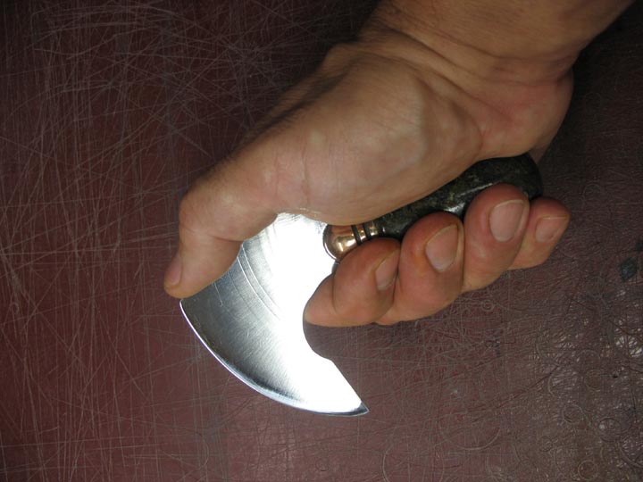

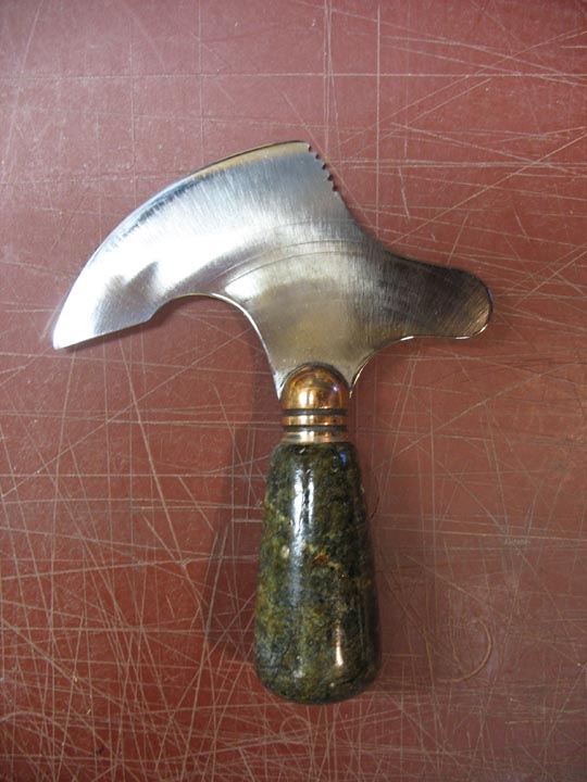

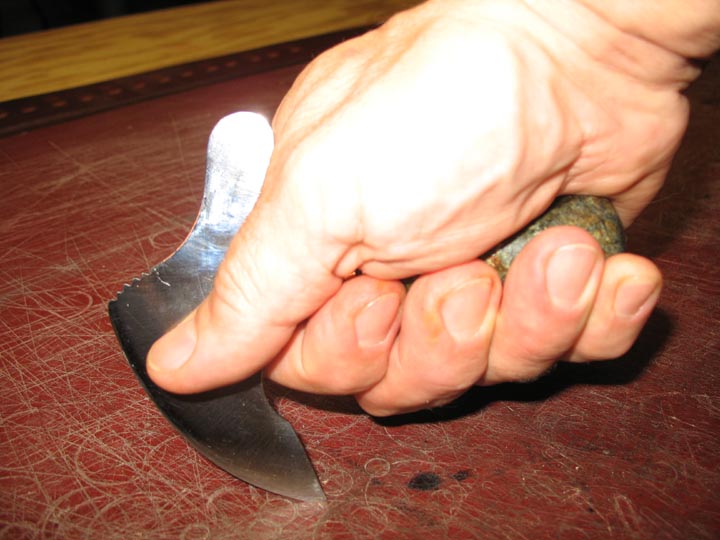

That was me. Here are the pictures.

Yes, that was it. No wonder why I could not find it! I did see that post but the pics seemed to have disappeared into the bowels of the internet.
I'll cut one out and see how I like it. I almost thing the handle needs the thin out and continue forward onto the thumb piece. That way the web of your thumb and index finger would not feel the back of the knife pushing in. Maybe I will make one both ways and go from there.

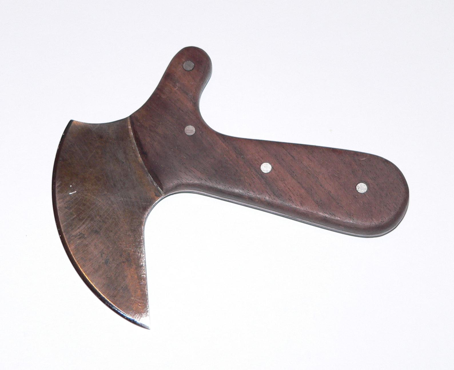

It took me a little while but I got it cut out on the plasma table. I cut two, that way I can mess one of them up and not feel bad. The other two in the picture are ones that I had started a while ago and got finished while contemplating this design. Hope to get handles on them in the next week or two. The metal used was an old hand saw blade. High quality carbon steed and there is no need to temper it after the knife is shaped.

So, you don't think that the temperature from the plasmacutter ruined the tempering of the steel?
The cutter is set to move pretty fast, as the metal is thin. The ones posted have not been touched since they were cut. You can see the discolorization along the edge of the cut, only about 1/16th of an inch thick. I will "sharpen" the cutting edge back past the discolorization to get past the softened area.
