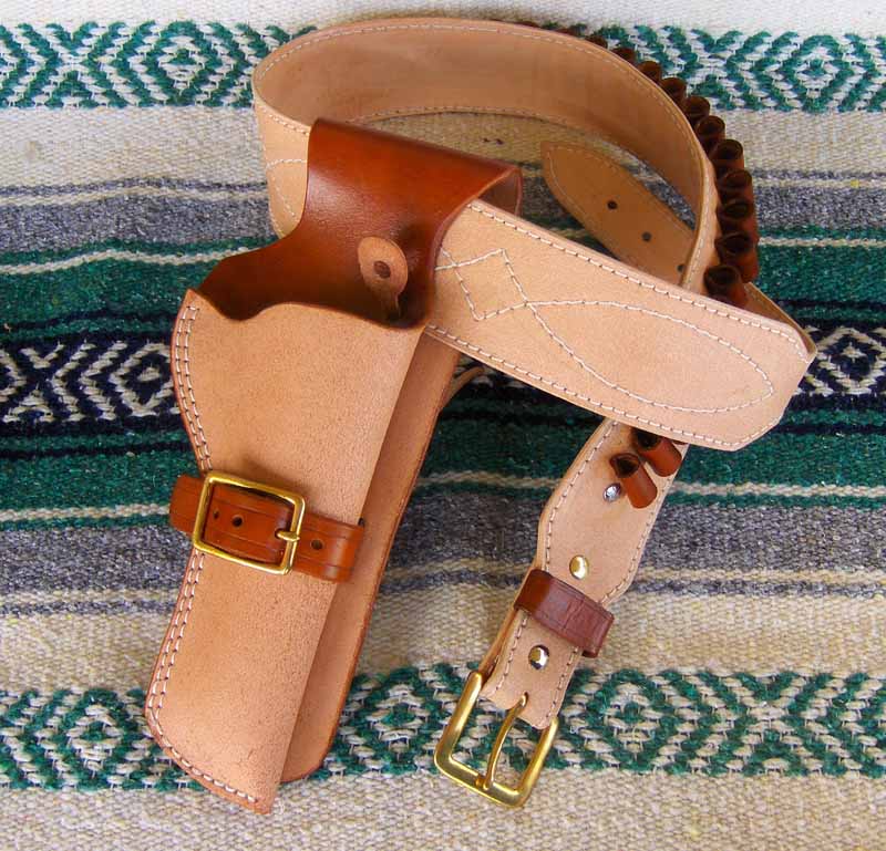

Members Dwight Posted September 10, 2018 Members Report Posted September 10, 2018 This is a picture of my money belt, . . . this one is a rough out leather belt, . . . since it is not curved to help keep it up, . . . the rough out takes over that job a bit. It is all one piece for the belt itself, . . . only sewn at the top, . . . and should easily hold silver dollar size coins. The buckle end has the usual treatment on the one end of it, . . . the other end goes down thru a 2 inch slot in the top and the bottom sections of the belt, . . . goes back under the belt and is fastened with the two snaps you see. Unless you have a pretty good size waist, . . . that many cartridges may get bunched quite a bit, . . . I'd probably do a shotshell slide if I wanted to take them with me for some reason. This makes a pretty belt, as well as a practical belt. May God bless, Dwight Quote If you can breathe, . . . thank God. If you can read, . . . thank a teacher. If you are reading this in English, . . . thank a veteran. www.dwightsgunleather.com

Members Dwight Posted September 12, 2018 Members Report Posted September 12, 2018 That's Feibings British Tan, . . . probably my most used color. I cut it 1 to 1 with Feibings thinner and dip dye all my projects. May God bless, Dwight Quote If you can breathe, . . . thank God. If you can read, . . . thank a teacher. If you are reading this in English, . . . thank a veteran. www.dwightsgunleather.com
