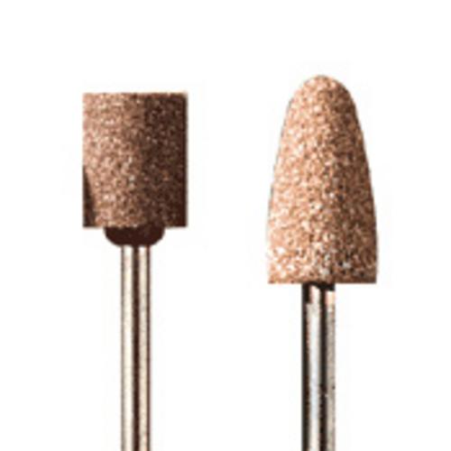

Members Red Cent Posted October 11, 2013 Members Report Posted October 11, 2013 (edited) Are we talking belt slots as in a pancake holster? The one on the right. Edited October 11, 2013 by Red Cent Quote https://www.facebook.com/redcentcustomleather?ref=bookmarks http://www.redcentcustomleather.com/
Members rccolt45 Posted October 12, 2013 Author Members Report Posted October 12, 2013 On 10/11/2013 at 10:30 PM, Red Cent said: Are we talking belt slots as in a pancake holster? The one on the right. Yes I am talking about a pancake style belt slot. Is the one on the right sand paper or a stone material? Quote

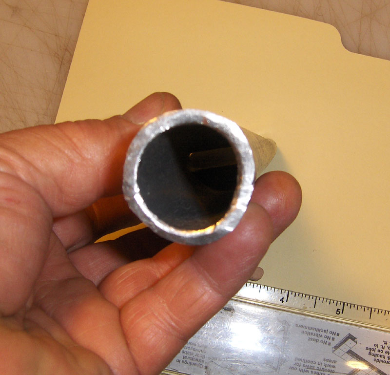

Members Dwight Posted October 14, 2013 Members Report Posted October 14, 2013 If you use a good slot punch, . . . the sanding needed is incredibly minimal. I got sick and tired of bad looking belt slots, . . . built a punch out of a piece of conduit, . . . sharpened the edge on an electric sander, . . . pounded it down to a 5/16 by almost 1 1/2 inch slot, . . . I've used it for 5 years, . . . looks ugly, . . . but it works. May God bless, Dwight Quote If you can breathe, . . . thank God. If you can read, . . . thank a teacher. If you are reading this in English, . . . thank a veteran. www.dwightsgunleather.com
Members Red Cent Posted October 14, 2013 Members Report Posted October 14, 2013 (edited) Yes, it is stone. At the rpm of the dremel, it will be smooth. Won't work with soft, thin leather. I like Dwight's idea. Gonna try that one. 'Course, one still has to do the edges with something. I use the edger, bone with an antler point to roll the edges down, then the dremel. Then the dremel with beeswax/parafin. Edited October 14, 2013 by Red Cent Quote https://www.facebook.com/redcentcustomleather?ref=bookmarks http://www.redcentcustomleather.com/
Members rccolt45 Posted October 16, 2013 Author Members Report Posted October 16, 2013 On 10/14/2013 at 1:55 PM, Dwight said: If you use a good slot punch, . . . the sanding needed is incredibly minimal. I got sick and tired of bad looking belt slots, . . . built a punch out of a piece of conduit, . . . sharpened the edge on an electric sander, . . . pounded it down to a 5/16 by almost 1 1/2 inch slot, . . . I've used it for 5 years, . . . looks ugly, . . . but it works. May God bless, Dwight Hey Dwight I would love to see a pic of this as punches are pricy. Quote
