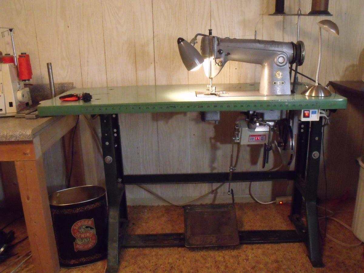

Members SARK9 Posted November 19, 2013 Members Report Posted November 19, 2013 New guy to the forum here. I'm having a bit of a time finding much info about this particular machine...I am wanting to set this up as a dedicated binder for edging a couple of layers of 1000D Cordura, but I'm finding conflicting info as to even which needle system is correct for this variant. I did find a parts list specific to this machine, but no general operating manual with the specs. I was pretty much given the machine and stand with not so much as a spare bobbin, let alone the paperwork. Has anyone here used of of these and/or maybe seen a copy of the manual? Thanks! -DonC. Quote
Cobra Steve Posted November 19, 2013 Report Posted November 19, 2013 Hi Don. This is a garment machine from the 40's and 50's. There are millions of them still around. It uses a 16X257 needle. It will work for what you want, but not as well as a walking foot or compound feed machine. Steve Quote

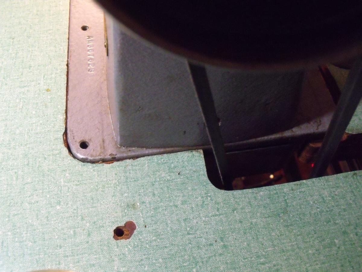

Members J Hayes Posted December 9, 2013 Members Report Posted December 9, 2013 Can you bore those races out and press in new bushings? Quote
Members SARK9 Posted December 9, 2013 Author Members Report Posted December 9, 2013 (edited) I will definitely try to sleeve the worn frames, though the casting is rather "elegant" and there's not a whole lot of wall thickness there to work with if the bushing itself is to have any thickness. I suspect the shaft is in poor shape as well, but haven't knocked it down to look. In terms of function and quality, I think its worth repairing, but the way its all mounted on this table is sort of not up to standard,... with a cobbled-on 2X6 sticking out the back of the table 4 or 5 inches to catch the outside bolts of its square mount. For now, I'll go back in the original *normal* motor mounting bolt holes and install a spare Consew CS1000 I have. -DC Edited December 9, 2013 by SARK9 Quote
Members J Hayes Posted December 9, 2013 Members Report Posted December 9, 2013 I didn't see the cobble job. Spare motor, seems like you have it solved already with no need to put time into the old one. Quote

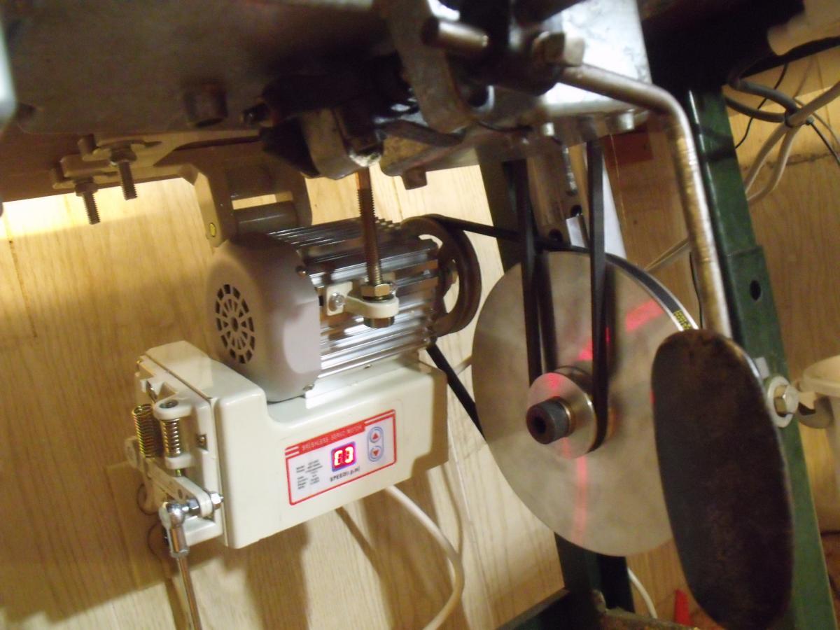

Members SARK9 Posted December 13, 2013 Author Members Report Posted December 13, 2013 Finished up the conversion to the CS-1000, and installed a torque multiplier while I had it all torn up. I didn't have a spare 50mm pulley with a 15mm bore to use on the servo, so I had to use the 90mm they come stock with. The 90mm pulley limits how close to your servo you can set the multiplier when using the standard motor mounting bolts. This sometimes causes your belt to rub on the near side end of the table's belt cutout. This one just barely cleared. The large pulley I made for this one is a 7.875" diameter; It would not have had the clearance for anything larger than an 8". -DC Quote
