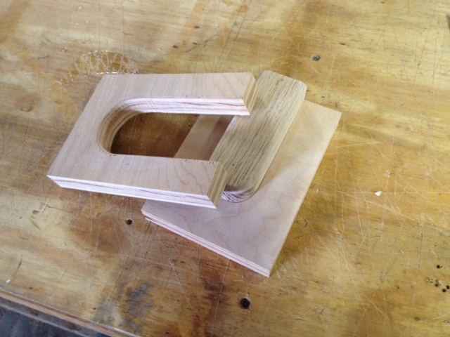

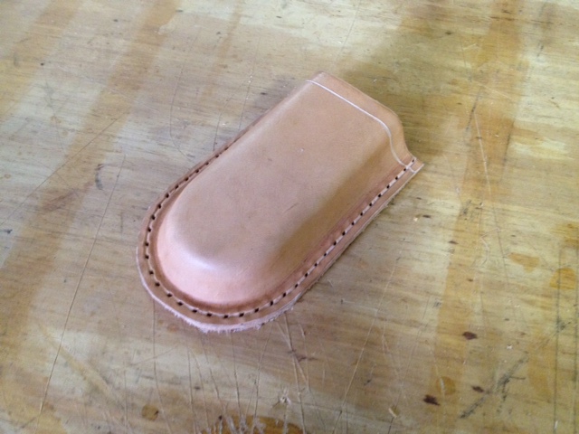

As far as doing it with no cut, sometimes I make a form out of wood mounted on a base piece. I then have another piece of wood with a negative cutout of the form (with a little extra room for the leather. You can use this to slowly clamp down on the leather and accomplish it without cuts. Look up Ian Atkinson on youtube. He has a video where he wet forms a pouch like I'm talking about.
Here is an example form and then a leather piece it produces...

Jack showed one of the best ways to do this, . . . it is one way I make my magazine pouches for hand guns.
One thing to keep in mind though, . . . the corners cannot be abrupt, hard angles. Soften the end of that multitool blank you used, . . . round it on the corners both horizontally and vertically, . . . then use Jack's method, . . . you will probably really like the result.
