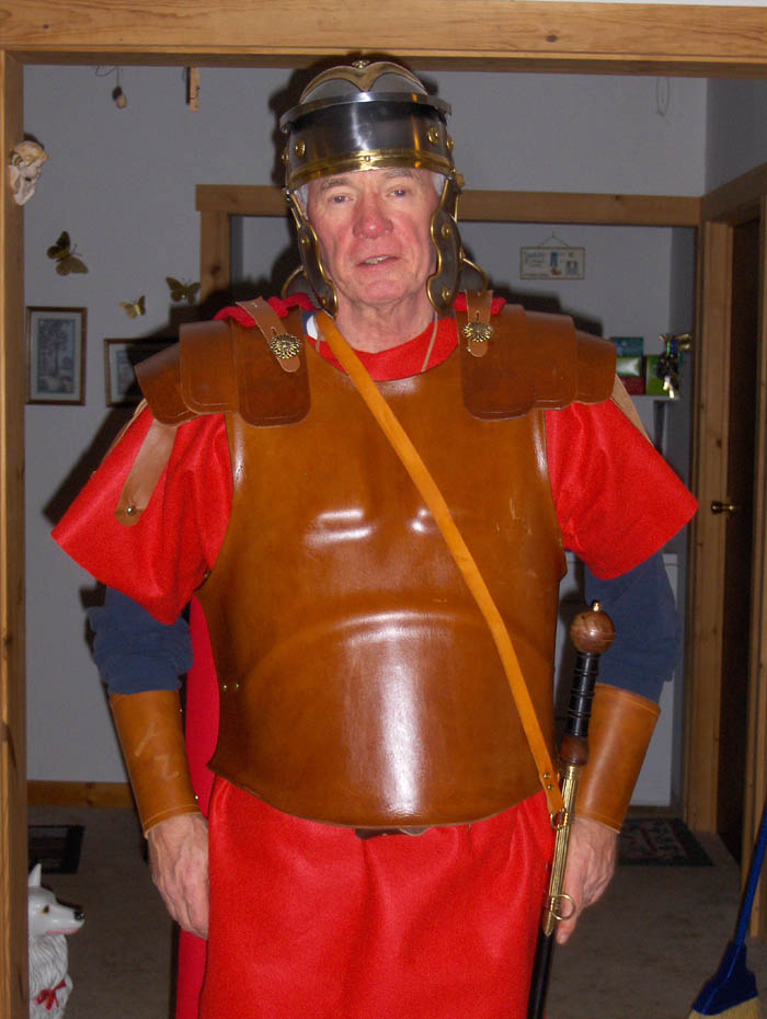

Members Dwight Posted December 14, 2013 Members Report Posted December 14, 2013 I used vegetable tanned leather for my armor, . . . made to look like the statue of Agustus Caesar (I believe it is in Rome???). It is about 4mm thick, . . . and I paid about seven dollars US per square foot for it. The wonderful thing about this type of leather, . . . it is easily worked, . . . cut, . . . sewn, . . . all that working stuff, . . . until you are ready to finish it. Then you dunk the whole thing in very warm water (around 130 deg F), . . . then mold it to the shape you want it, . . . let it dry, . . . and it will dry fairly hard. I made a mold of my upper body, . . . and did the above process, . . . and now I have my alter ego: Centurion Salvatorus Antonio, Centurion of Capernaum, of the Sixth Legion. May God bless, Dwight Quote If you can breathe, . . . thank God. If you can read, . . . thank a teacher. If you are reading this in English, . . . thank a veteran. www.dwightsgunleather.com

electrathon Posted December 17, 2013 Report Posted December 17, 2013 I made a mold of my upper body, . . . and did the above process, . . . and now I have my alter ego: Centurion Salvatorus Antonio, Centurion of Capernaum, of the Sixth Legion. Dwight, You set yourself up for this. If you molded this to your body you have the strangest shaped man boobs and six pack ever. LOL Aaron Quote
Members Dwight Posted December 17, 2013 Members Report Posted December 17, 2013 What can I say, . . . the centurions of that day were a strange lot, . . . just following in the footsteps,................ Actually, . . . I modeled it somewhat after Ceaser Augustus statue, and a couple more I saw here and there. The "up and over" inverted C above the abdomen was a piece of rubber hose I had laying around, . . . needed something there to add a little rigidity, . . . it worked. Anyway, . . . most of the folks are too fascinated with all the other accouterments, . . . the armor gets a pass. May God bless, Dwight Quote If you can breathe, . . . thank God. If you can read, . . . thank a teacher. If you are reading this in English, . . . thank a veteran. www.dwightsgunleather.com
