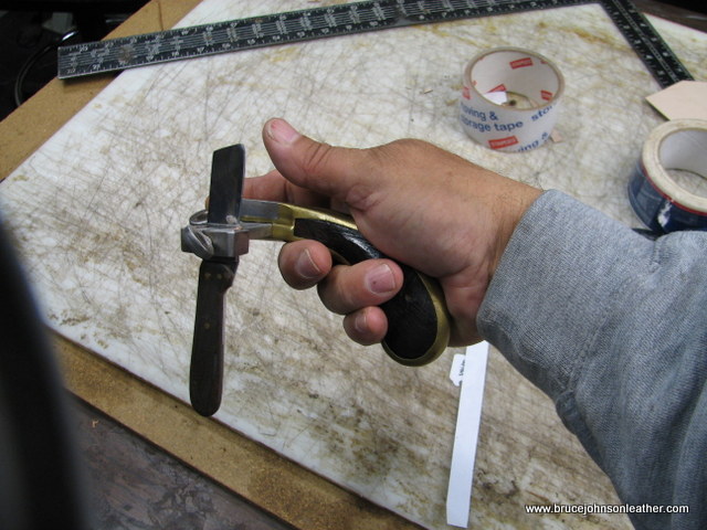

I was given one of these from the upholstery guy at work. I can not get it to cut a good strap. The leather tends to ride up on the "fence" portion of the cutter. Not sure if it is something I am doing wrong or something else.
Edited by glockanator
  • Moderator

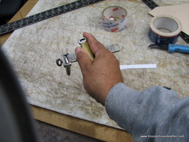

I definitely agree with TXAG, it sounds like a sharpening problem first. The blade needs to be sharp enough that it easily pulls into the leather. The blades never come sharp enough. I am attaching a couple pictures of how I grip one also. I point my index finger down the right side of the handle. My middle finger is on the trigger. My thumb lays over the leather to keep it down. This is how I was retaught and works well for me. The biggest lesson I learned for cutting consistant straps was to stop looking at the blade when I am cutting. Just watch the leather staying up next to the guide. If the leather is staying there, the blade is taking care of itself. Good tip for a plough gauge, ripping boards with a table saw, etc. The natural tendency is to watch the blade cutting because that is where all the action is. The leather wanders away from the guide and things go out the door from there.
Also I set my draw gauges up so the blade tips toward me as much as the slot will allow. That slicing action helps to hold the leather down on the bar. If the blade is tipped away a bit, the leather tends to ride up the edge.

Good tips Bruce, thanks.

Great tips Bruce, thanks so much for sharing the pictures they help a lot. Any tips for those of us that just have the standard Osborne blades that don't have the handle on them?

I mostly use the standard Osborne blades, the test monkey in the picture happened to have my last Buchman blade. For the OSbornes I take the shoulders down on the bevel and then sharpen out to a foil edge and strop that off. I spend about 2/3 of the time on the part of the blade that faces the handle and 1/3 on the outside. That very empirical and imprecise method gives me the bevel I like for the blade to draw the leather in without binding.

So I took Bruce advice and changed how I was holding the cutter as well as started using box cutter blades instead of the tandy blade. I also started talking my time when doing this and have not had any more problems.
