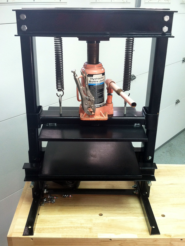

Andy, how did you modify your press machine from harbour freight?
Weaver has Clickers and also makes custom Dies. Never priced the dies so I couldn't give you any pricing info.
I cut off the ram rod (the steel cylinder hanging directly below the jack). Then welded two 1/2" thick steel plates, one to the bottom cross brace and the other to the top. Works great! I've since cut about two feet off the legs and have the press mounted to a workbench. I'll take some pictures and post them up tonight if I get a chance.
Ok thanks alot i would like to see pictures im thinking about doing this instead of buying a clicker machine but im just looking at the different options before i make any decision first.

Here you go... as you can see I cut the legs down so it fits on my workbench. I left enough on the bottom so I can adjust the table up or down a notch for cutting or stamping. Works great! And of course I had to paint it black! ;-)
