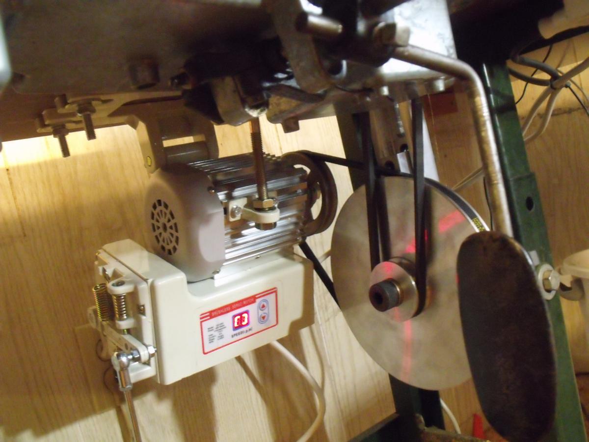

Members dikman Posted July 31, 2023 Members Report Posted July 31, 2023 I fitted a rather large pulley to my Seiko, it meant I didn't need to mess around with a reducer, the pulley was in my spare pulley box and I just needed to make a sleeve for the shaft. Quote
