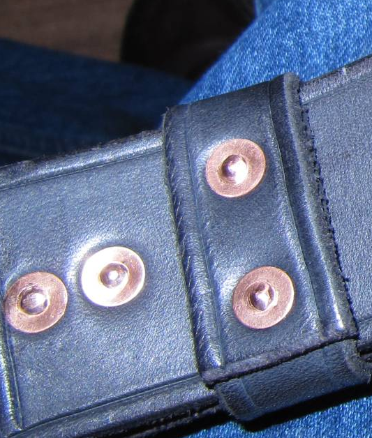

Are you using a rivet setter? Most copper rivet setters have a holl. Once you have pusehed the burr onto the shaftof that rivet place the hole in the setter over the shaft and drve down until the burr is flush agaunst the leather. Once I have the burr setI cutt the shaft using nail nippers I put the end of the nippers flush against the burr. The angle of the edge seems to give me the right amount of the shaft left. I take a partial cut then rotate the nippers a little then cut again doing that all the way around the shaft. When I make my final cut I have kind of a pyrmid at the shaft end. Using a the domer portion of the setter I dome out the shaft end and have a nice tight fit. If you do not have a setter peen it using light taps with the flat face of a hmmer until the shaft is flaired out. Here is an example of copper rivets I have done.
post-15001-0-28046600-1396377465_thumb.p
I got it to somewhat work a few days ago might need a proper anvil since i was hammering the area on a unstable wood table, which is why my burr didn't sit flush and i couldn't peen the post. I now see the error i was making appreciate the responses.
Camano, that's quite nice rivet setting. Whose peening tool are you using? I find that the Osborne one is essentially useless for setting the burrs or doming the rivet.
