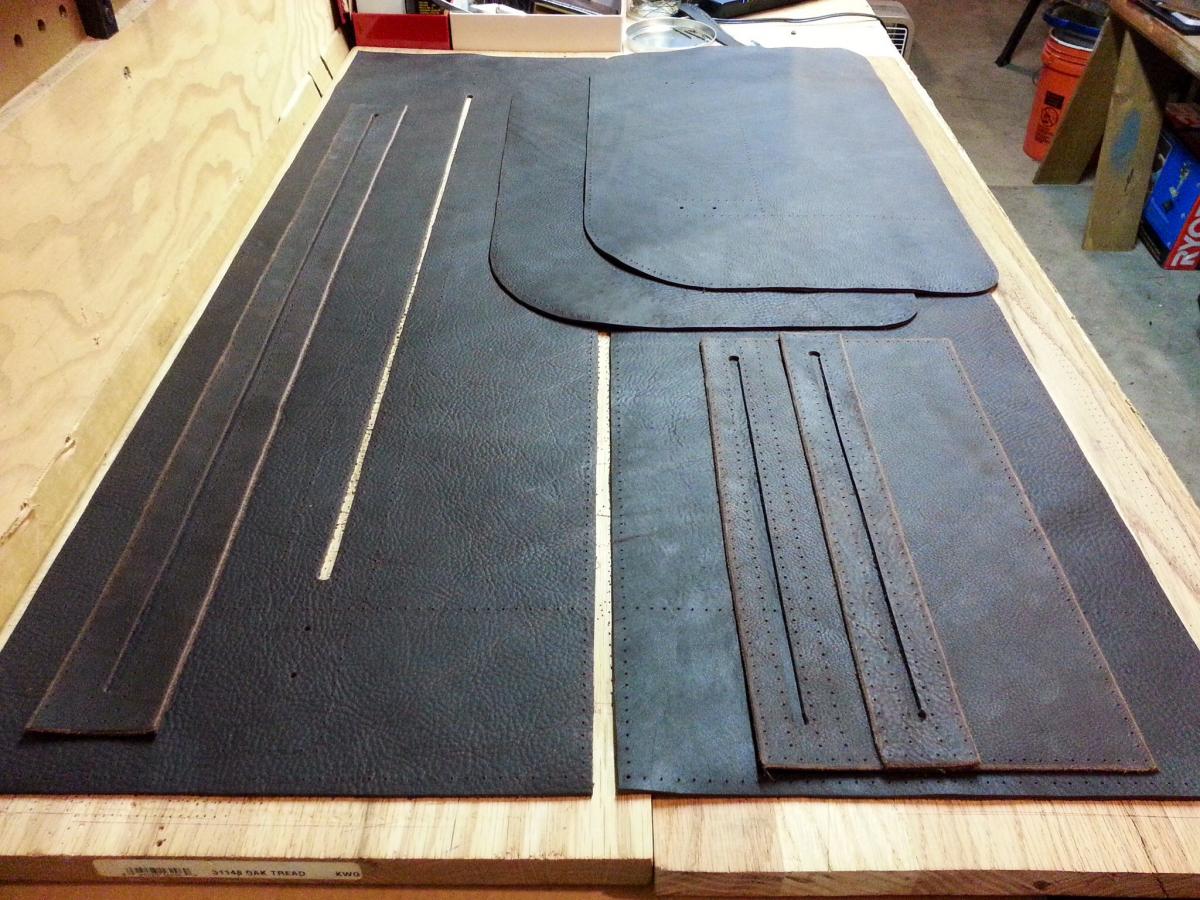

Hi capster, the customer picked this out from a few swatches I have from Waterhouse leather. I think he made a great choice. Stitching holes... my nemesis. Generally, I include them on the pattern itself. I find my work looks better. The straps are the exception in that I will lay down the grove and run a wheel or mark it with a ruler and then punch.
In this project, I marked and then pre-punched "awl" 3,600 holes. In some sections I was sewing through 4 layers so I knew better than to try and punch and sew as I went. I've included a few extra photos of some of the punched panels and a few stitching shots.

Thanks for adding extra pictures. I hope you show these to the client - it makes it a lot more obvious how difficult it was. And shows the texture of the leather nicely.
