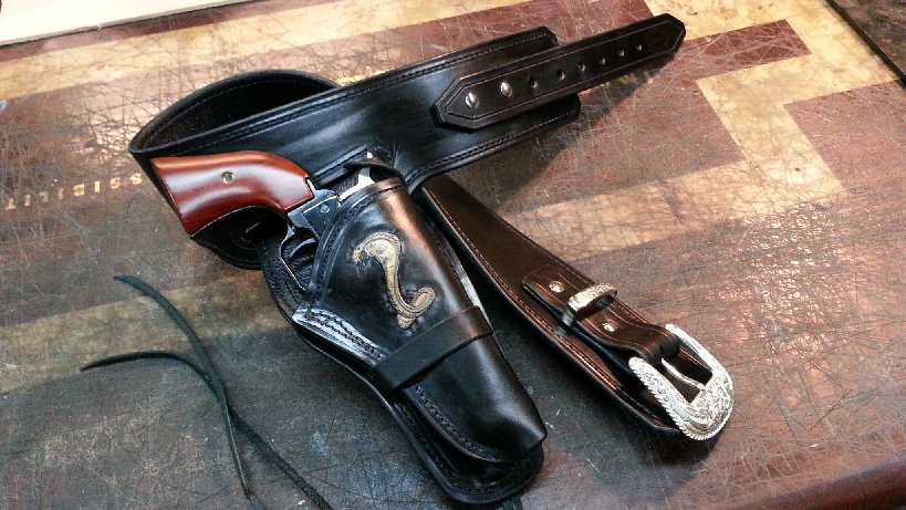

Members Josh Ashman Posted April 28, 2014 Members Report Posted April 28, 2014 (edited) I cut my belts straight with a draw gauge or strap cutter then form them into a curve when they are cased for tooling. I think it helps to get a hide to go farther and keeps thing simpler, but that's just my opinion. A single layer of 10/11 forms into a curve pretty easily. The picture below has buscadero drops so I cut it with the drop loops towards the back off of a new hide. that gave me a straight edge that I cut both cartridge belts and regular belt blanks from until I was down to the belly. As for how to figure out length and placement, I use a 15" tongue billet with 7 holes spaced @ 1" starting 3-1/2" from the end and a buckle chape that measures 6" from the center of the fold to the end, overall length is probably around 8" or so. I place the buckle at about the end of the main belt body and put the 3rd hole of the billet wear the customer currently wears a gunbelt. This works for me to get a balanced looking rig. A rough estimate for sizes is that Levi or Wrangler pants size to a regular belt is about +3" while the same pants size to a cartridge belt is about +6". Everybody is different but that is generally pretty close in my experience. Best regards, Josh Edited April 28, 2014 by Josh Ashman Quote
