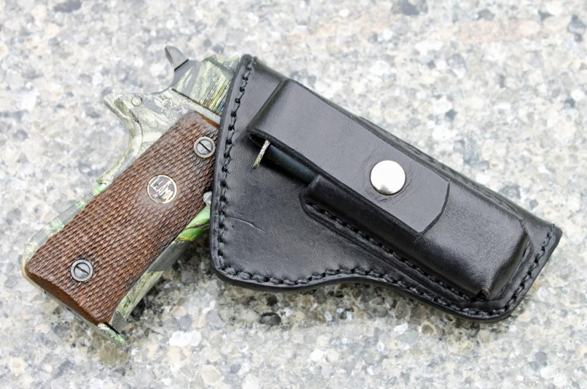

Chief31794 Posted April 16, 2014 Report Posted April 16, 2014 This is the neatest gun I've seen in a while, it comes with two cylinders, 22 MAG and 22 LR. The holster wasn't easy to make as there isn't a lot of room to work with and the customer wanted to clip it to the outside of his pocket on his jeans. He also wanted plain leather and Black. So this is what I came up with. The .380 was a little more conventional, although it is pretty small as well and he wanted to put a magazine pouch on the outside of the holster itself. Chief Quote

Members Leprechaunleather Posted April 16, 2014 Members Report Posted April 16, 2014 1911 in a .38 nice !Great work by the way ! Quote
Chief31794 Posted April 16, 2014 Author Report Posted April 16, 2014 Looks like you did a good job on those holsters. I'd like to see the back of that American Arms holster to see what kind of clip you used. Nice work there. No clip, he didn't want one on this, he did on the derringer. He wanted to be able to put it on his belt and make sure it stayed in place so I used two belt loops, shorter than normal so they would fit snug, he can run the belt through the back one then through a belt loop on his pants and then through the other and the holster will not be able to slide around. I'd never done that before, but it was what he wanted. 1911 in a .38 nice !Great work by the way ! Thanks, the .380 is kind of neat in a 1911 type weapon, the weapon is small, hard to tell in the picture, I would estimate about 75% size of a normal 1911 or a little less. The camo job was done by a guy he knows. It is pretty sharp in person, the guy normally does long guns but I think this turned out pretty nice. Pics of the backs. Chief Quote
