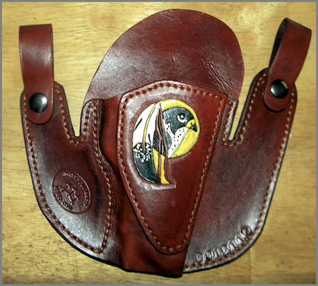

Members Dwight Posted May 6, 2014 Members Report Posted May 6, 2014 (edited) I don't have a lot of experience, . . . but what I have done seems to be working out. Here's an example of acrylic paint on veg tan, dyed with Feibings British tan, . . . then a coat of resolene, with the paint applied last. It was also carved and a little stamping done, which is not really apparent in this picture. May God bless, Dwgiht Edited May 6, 2014 by Dwight Quote

Members DavidL Posted May 6, 2014 Author Members Report Posted May 6, 2014 I don't have a lot of experience, . . . but what I have done seems to be working out. Here's an example of acrylic paint on veg tan, dyed with Feibings British tan, . . . then a coat of resolene, with the paint applied last. It was also carved and a little stamping done, which is not really apparent in this picture. May God bless, Dwgiht very nice project. What brand of acrylic? How is it holding up? I like to protect the paint from wear. I use a acrylic matt medium over the paint as a top coat and 50/50 resolene over the entire piece as a finish. I will try that. thanks Quote
