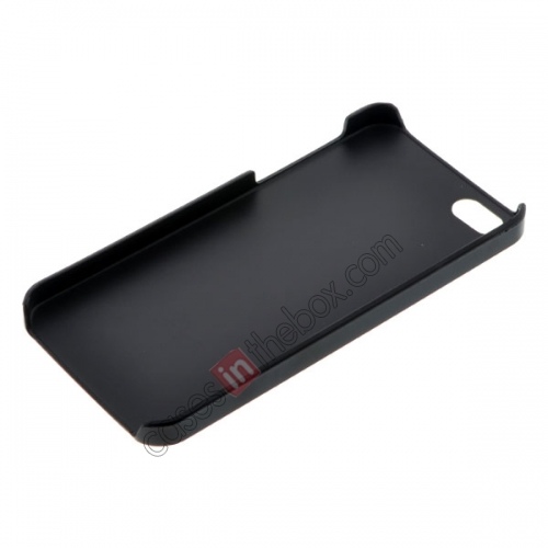

What glue do you use to attach a plastic clip-in /; snap-in cell case (iphone, etc. etc.) to the inside of leather?
Last night I tried 8 different adhesives.... (yes, EIGHT)
I Had a long strip of plastic, and I cut 8 pieces of leather all from the same hide. I Labelled all 8 and glued away.

Example of plastic case below or attached.
superman-hard-plastic-case-for-iphone-4-forest-camouflage-pattern-glossy-plastic

Assuming you are gluing to the outside of the case, I would first clean the case with acetone and remove and mold release then I would really rough up the surface with a low grit paper or wire brush. The I would use a high solids solvent based cement like barge cement coating both sides and allowing to dry to slightly tacky.
