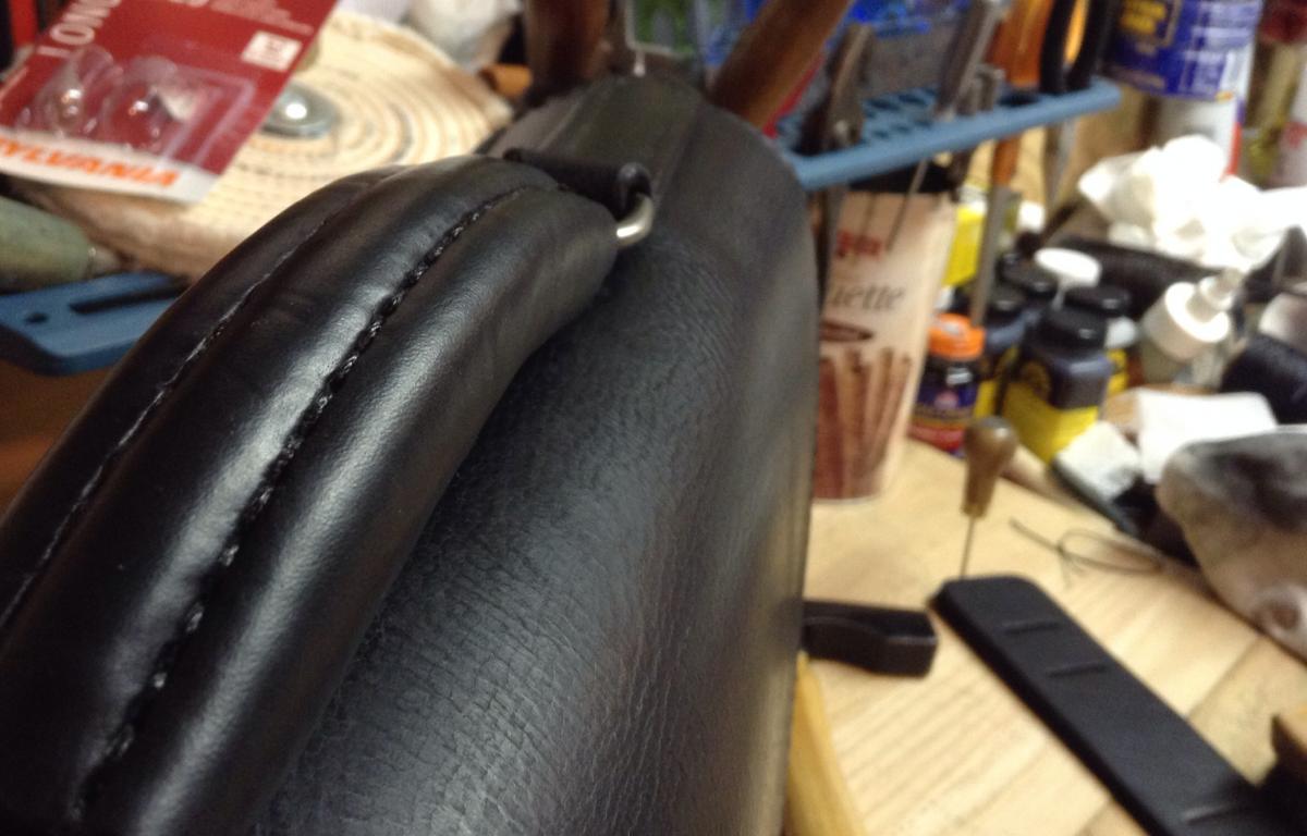

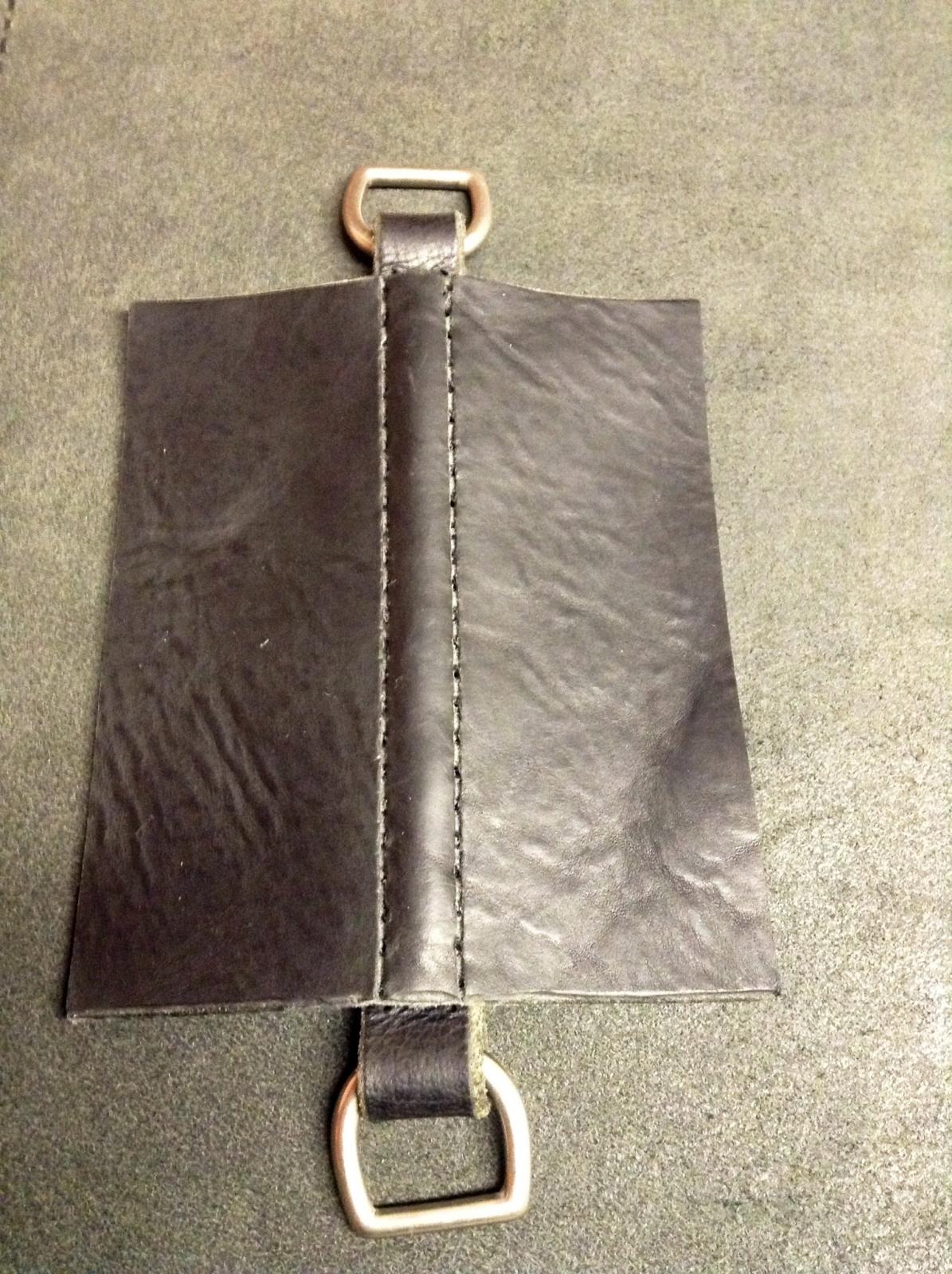

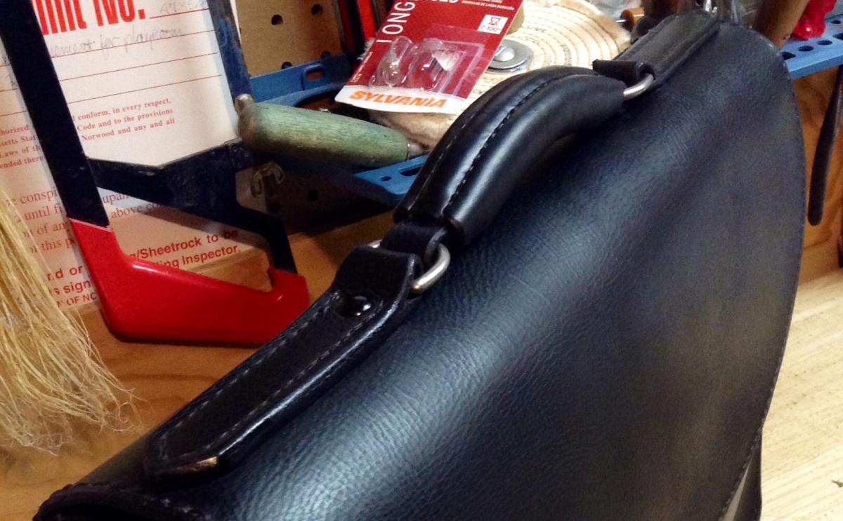

Members Paulsleather Posted June 19, 2014 Author Members Report Posted June 19, 2014 (edited) Thanks 73 and Benlilly. LTC I'm not exactly sure but I would guess 5, maybe 6 lbs. Thanks, Trevor. Yes, all hand stitched. I posted a few pics that will help highlight the construction. Hard to document it all in words but I'll try. I started with a long strip which spans the length of the handle and attaches to the d rings. I then glue a narrow strip down the back of that. Next, I glue the raw flap of the handle on top. Oops, Prior to that I run two grooves for stitching the flap onto the underlying center strap. Mark with a wheel, punch the holes and then stitch. I then glue another two layers to the bottom side and then clamp it all for a spell. The subjective part comes next. With a knife I round off the edges and check the thickness and shape. When I'm happy with that I turn Down the flaps and cut them to length so that they meet in the middle. Then I run a groove on each side, mark it with a wheel and punch the holes. Lastly, I tie the handle flaps together with a baseball stitch. Hope that helps! Paul Edited June 19, 2014 by Paulsleather Quote
