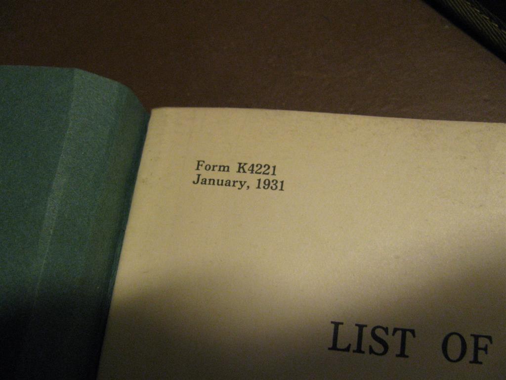

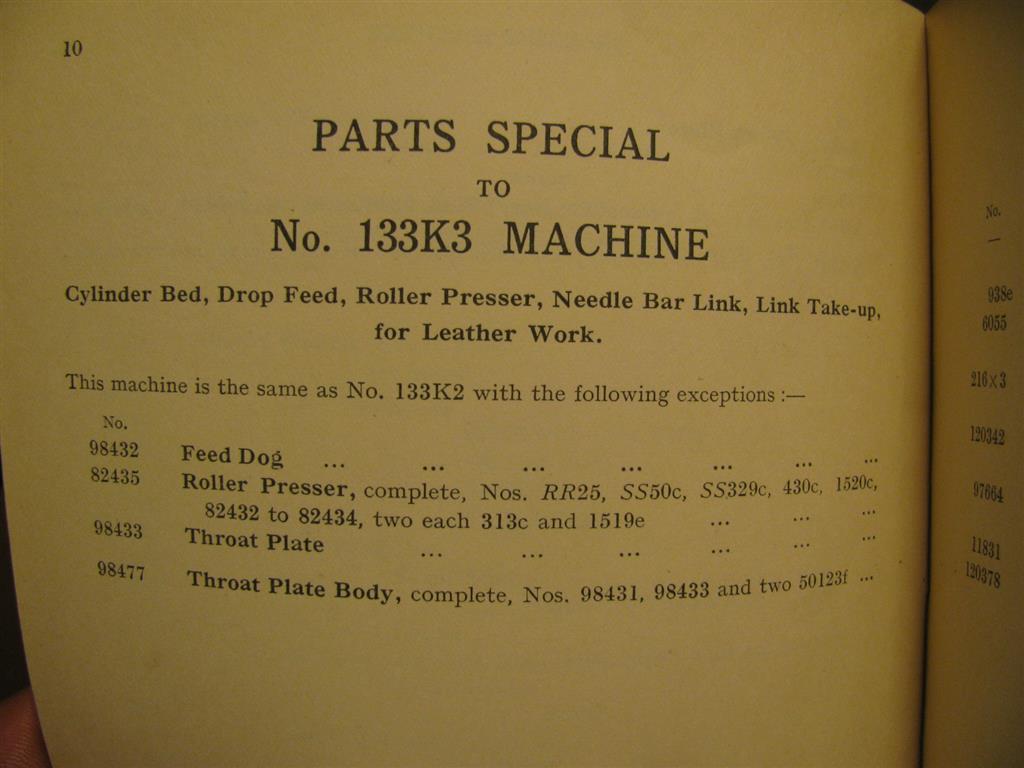

Members Constabulary Posted December 7, 2014 Author Members Report Posted December 7, 2014 (edited) If someone is looking for an original 132K manual - I have found one on Ebay: http://www.ebay.de/itm/261685215520?ssPageName=STRK:MEWAX:IT&_trksid=p3984.m1423.l2649 I will not bid. I also have found and original 1931 dated parts lits for my 133K3. Unfortunately not illustrated but I love original documentations. I figured the difference between 133K2 and 133K3 is that the 133K3 has a roller foot. Really too bad the parts are not illustrated But I figured that my tension unit should have a felt washer so seems I have to make one... Still learning about the machine - I like it! Edited December 7, 2014 by Constabulary Quote
