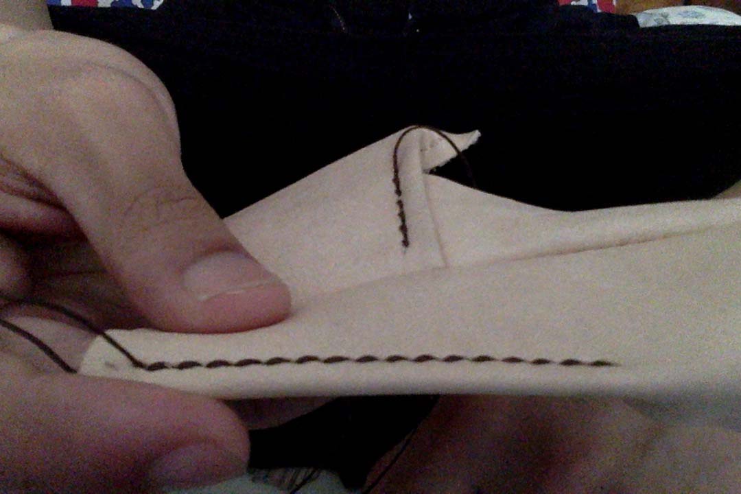

Members Hi Im Joe Posted June 29, 2014 Members Report Posted June 29, 2014 I'm not sure how to answer your question. In the picture you posted you would not use a "french" bound edge. A french edge is one where you glue the lining on the grain side of the leather grain to grain. Then you stitch the lining to the hide. Then you roll the lining over the edge of the leather and stitch it down to catch the lining a second time. Example: https://www.google.com/search?q=french+edge+binding+leather&spell=1&tbm=isch&ei=oJOvU_n4H82ZyAS1koL4Cw#q=rolled+edge+leather&tbm=isch&facrc=_&imgdii=_&imgrc=RUlGtjc9AxU21M%253A%3BZgm86QHEC97R-M%3Bhttps%253A%252F%252Fsalukifeathers.com%252Fwp-content%252Fuploads%252F2013%252F10%252FDSC_7570.jpg%3Bhttps%253A%252F%252Fsalukifeathers.com%252Fpost%252Fgallery%252Ftooled-leather-dog-collars-gallery%252F%3B640%3B424 You calculate it exactly how I described. You have the stitching allowance (I accidentally called this the turnover allowance in my earlier post. This is usually 8 to 10 mm) and then you have the turnover allowance (the thickness of the leather you are turning the edge over). Add these together to determine how much length/width to add to your pattern. For example: I have a wallet. I want to stitch it 4mm in from the edge. I know the thickness of the divider and card pocket adds up to 2.5mm. I just add 8mm (4x2) plus 2.5mm which equals 10.5mm to the overall length for each side of the wallet that I have a turned edge on. So since the top is open and will not have a bound edge that means I need 10.5mm to the width of my wallet pattern. However, both sides of the wallet will be bound therefore I need to add 21mm (10.5 x 2) to the length of my wallet pattern. Hope that helps. This is really hard to describe in text. Quote http://www.sevenhillsleather.com/
Members DavidL Posted June 29, 2014 Author Members Report Posted June 29, 2014 (edited) I'm not sure how to answer your question. In the picture you posted you would not use a "french" bound edge. A french edge is one where you glue the lining on the grain side of the leather grain to grain. Then you stitch the lining to the hide. Then you roll the lining over the edge of the leather and stitch it down to catch the lining a second time. Example: https://www.google.com/search?q=french+edge+binding+leather&spell=1&tbm=isch&ei=oJOvU_n4H82ZyAS1koL4Cw#q=rolled+edge+leather&tbm=isch&facrc=_&imgdii=_&imgrc=RUlGtjc9AxU21M%253A%3BZgm86QHEC97R-M%3Bhttps%253A%252F%252Fsalukifeathers.com%252Fwp-content%252Fuploads%252F2013%252F10%252FDSC_7570.jpg%3Bhttps%253A%252F%252Fsalukifeathers.com%252Fpost%252Fgallery%252Ftooled-leather-dog-collars-gallery%252F%3B640%3B424 You calculate it exactly how I described. You have the stitching allowance (I accidentally called this the turnover allowance in my earlier post. This is usually 8 to 10 mm) and then you have the turnover allowance (the thickness of the leather you are turning the edge over). Add these together to determine how much length/width to add to your pattern. For example: I have a wallet. I want to stitch it 4mm in from the edge. I know the thickness of the divider and card pocket adds up to 2.5mm. I just add 8mm (4x2) plus 2.5mm which equals 10.5mm to the overall length for each side of the wallet that I have a turned edge on. So since the top is open and will not have a bound edge that means I need 10.5mm to the width of my wallet pattern. However, both sides of the wallet will be bound therefore I need to add 21mm (10.5 x 2) to the length of my wallet pattern. Hope that helps. This is really hard to describe in text. That clears things up. I didn't do a french seam where the inside is also folded over.What I have is just two pieces of leather stitched grain side to grain side and then folded over what I meant by my previous post is the thicker the leather that I'm going to be rolling over the more length I will need. For example I take tape and bend it over the edge to measure it out for the pattern, when I take that piece of leather cut from that measurement it will be slightly smaller then I need it since the thickness of the piece I'm rolling over doesnt bend as easily as tape. If only I had a skiving machine. By rolling the edge I mean the way the front side of your wallet bends over the edge and stitches connect the back and front side. The picture below adding leather pieces in the middle. Edited June 29, 2014 by DavidL Quote
