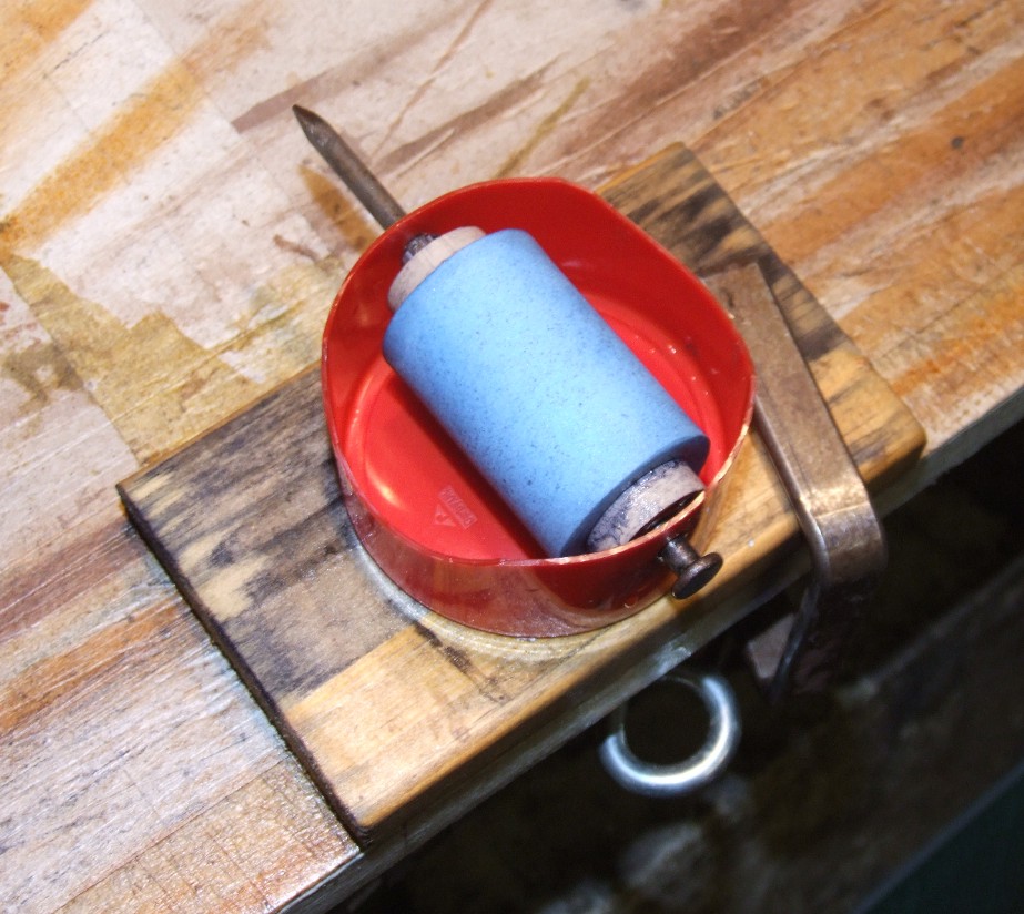

Posted (edited)
A couple of years ago I landed a contract to make 100 belts for the Nicole Miller fashion house in the US. I couldn't face the thought of edging them all with a dauber or brush, so I made the little gadget pictured below. The reservoir is the cap from an aerosol can, and the central spindle is the plastic core from a thread spool. I hunted around for a not-too-soft foam to cover the spindle, and used a 3mm thick foam innersole, which is glued to the spindle. It's really easy to just draw the edge of the belt along the roller, which is constantly replenished from the reservoir.
I use it all the time now, but it's only suitable for non-spirit based dyes, such as Fiebings Edge Dye or Edge-Kote. Spirit-based dyes make the foam expand and disintegrate. It's saved me hours of fiddly work with a brush, and cost me nothing!

A couple of years ago I landed a contract to make 100 belts for the Nicole Miller fashion house in the US. I couldn't face the thought of edging them all with a dauber or brush, so I made the little gadget pictured below. The reservoir is the cap from an aerosol can, and the central spindle is the plastic core from a thread spool. I hunted around for a not-too-soft foam to cover the spindle, and used a 3mm thick foam innersole, which is glued to the spindle. It's really easy to just draw the edge of the belt along the roller, which is constantly replenished from the reservoir.I use it all the time now, but it's only suitable for non-spirit based dyes, such as Fiebings Edge Dye or Edge-Kote. Spirit-based dyes make the foam expand and disintegrate. It's saved me hours of fiddly work with a brush, and cost me nothing!Just to show off, there's also a pic of Nicole Miller wearing one of the belts (not sure who the other girl is . . . maybe someone called Gershon?).
That's a terrific! It's a mini version of the edge dyer that Weaver sells for lots of money. I like the size of yours better!
