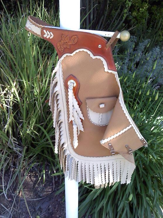

As an after thought I thought you might like a photo or two of what we are talking about. These are old past projects of mine. The pink pair was a pair of batwing style chaps brought in to be made into chinks.
The hair on pair I did for a shop example, the same with the two tone pair, but a customer bought them to hang on his wall.
