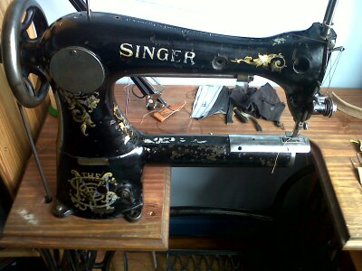

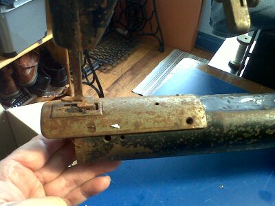

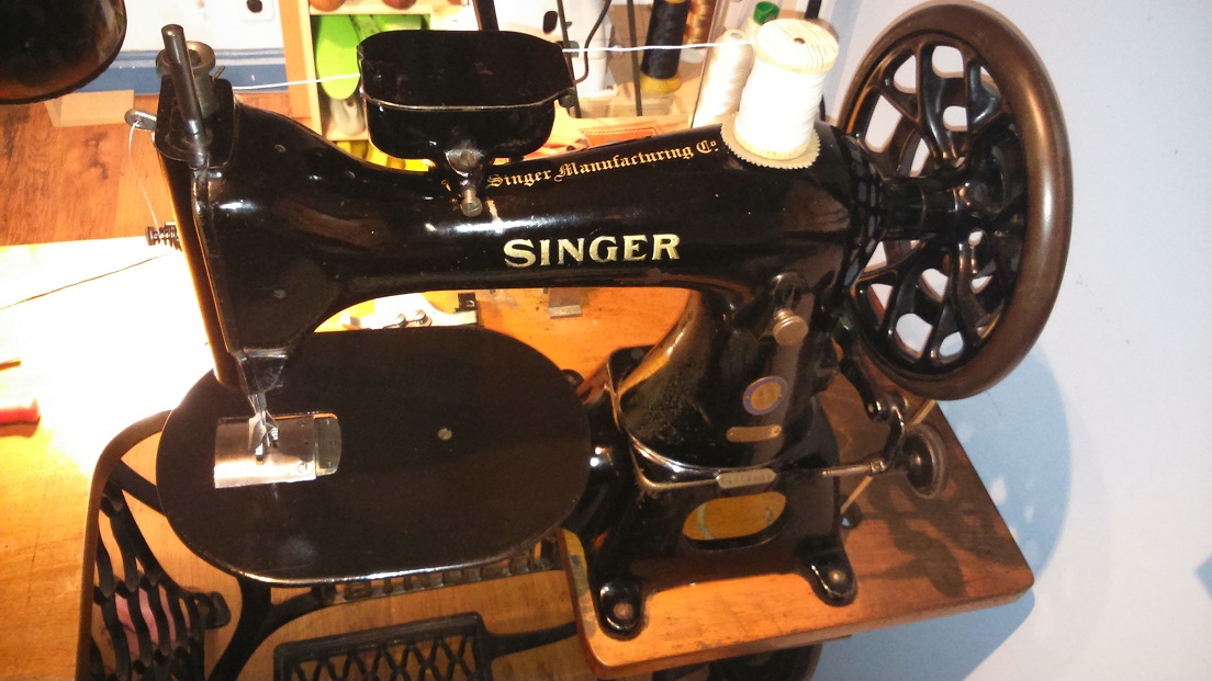

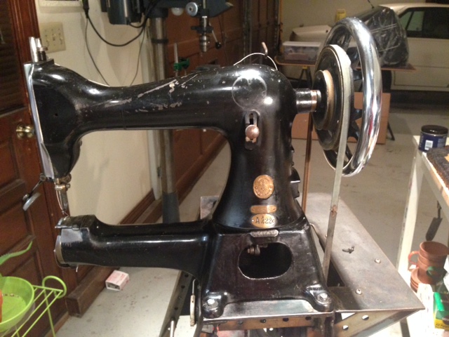

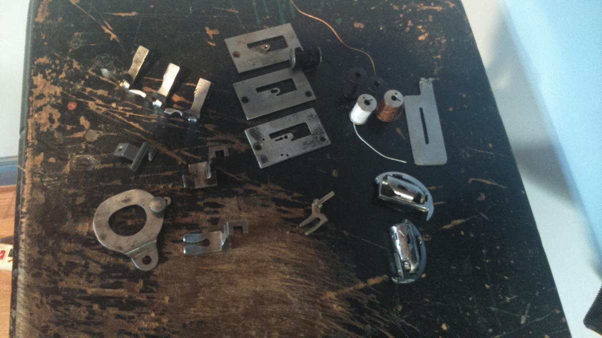

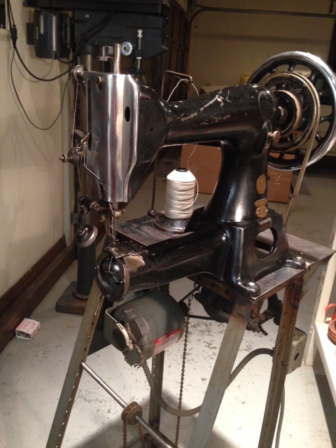

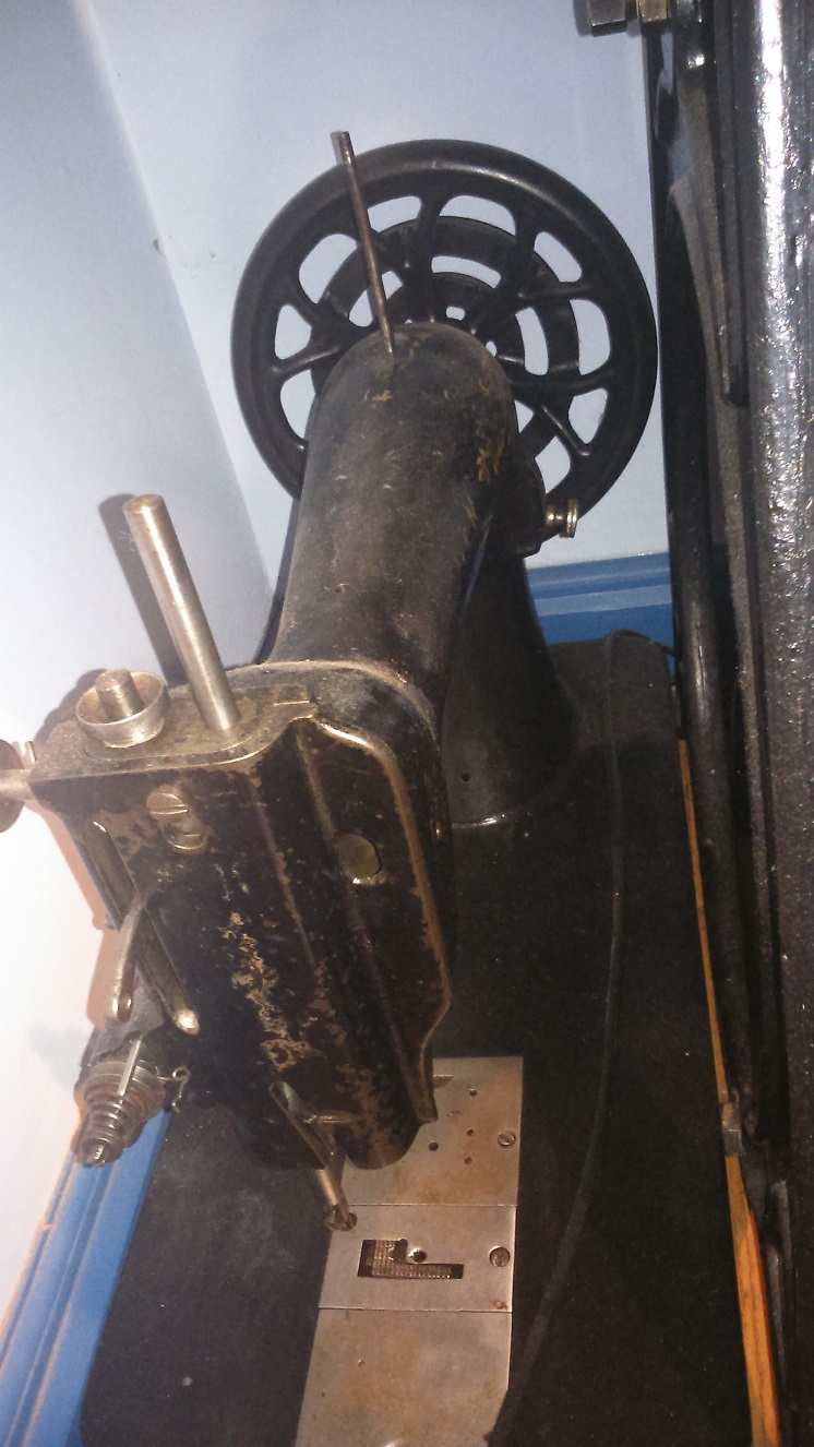

Recently I purchased a 45K25. That in itself isn't unusual. What is a bit unusual is I know next to nothing about sewing or sewing machines, I just seem to have become attracted to them in my later years. With that in mind, I would greatly appreciate any advise or guidance you care to offer.
The machine was manufactured February 12, 1940, in Clydebank, Scotland, according to Singer. The serial number is EC 636333. It has an additional plate riveted on the face, below the class/subclass number, marked "A 222", no one so far knows why. I'm extremely pleased to have the machine and would like to restore it properly, but within reason. I don't think it would be prudent to invest more in it than it's worth; I learned quickly that's easy to do. Here are a few pics.
post-52198-0-54941500-1416284440_thumb.jpost-52198-0-65746100-1416284441_thumb.jpost-52198-0-18359100-1416284932_thumb.j

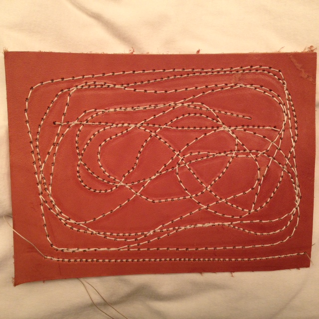

The machine seems to be fairly tight, there is 2 mm of free circular movement at the shuttle end, 1 mm each way without the flywheel moving. With the help of a couple of fine people here on LW, the machine was sewing (note I said was). Here's a sample in 9 oz. veg tanned, I think.
post-52198-0-92299700-1416287945_thumb.j
So the question is, what would you advise doing to this attractive 74 year old machine? Thank you, thank you very much.
Edit: You'll recall I said it "was" sewing. I'll discuss that in another topic titled Singer not feeding.

Hi There, this is the only manual i have seen for this class of machine on the net.
45Kmanual.pdf
post-32832-0-15806600-1416356431_thumb.j
Jimi,
Thank you, that's an excellent manual, very helpful. If you ever come across the service/mechanics manual, would you please let me know? What do I owe you for this one?

When you thread the tension piece on the faceplate of your 45K25, do you wrap the thread completely around the pulley wheel? Thank you Jimi.
Yes, that would be one and a half times around.post-32832-0-84186800-1416609871_thumb.j

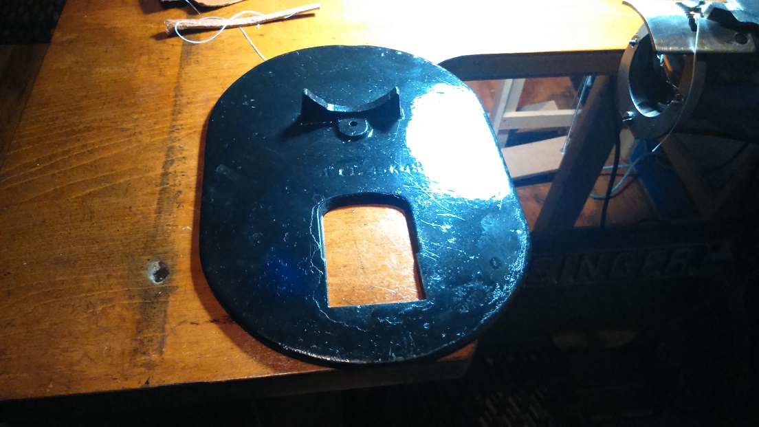

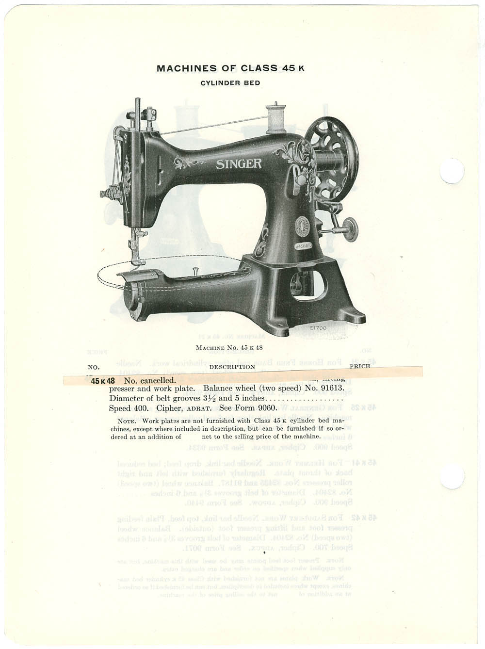

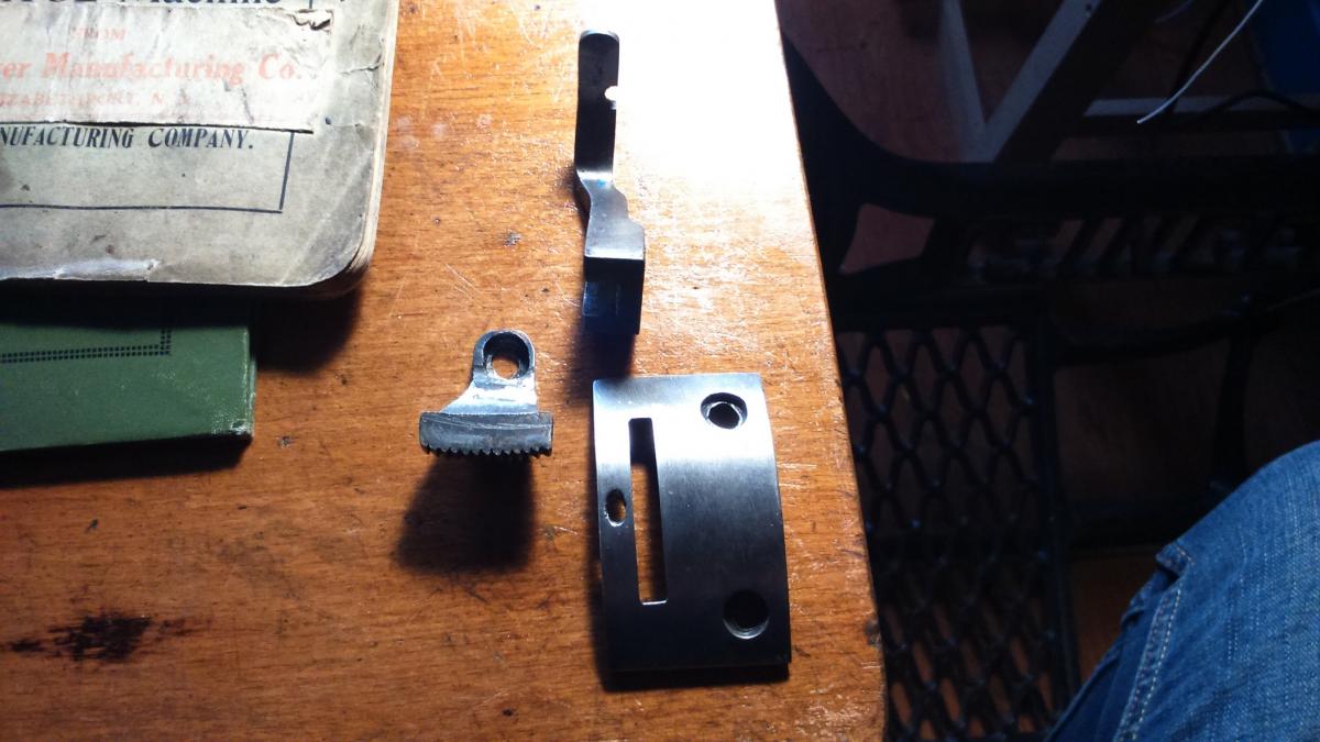

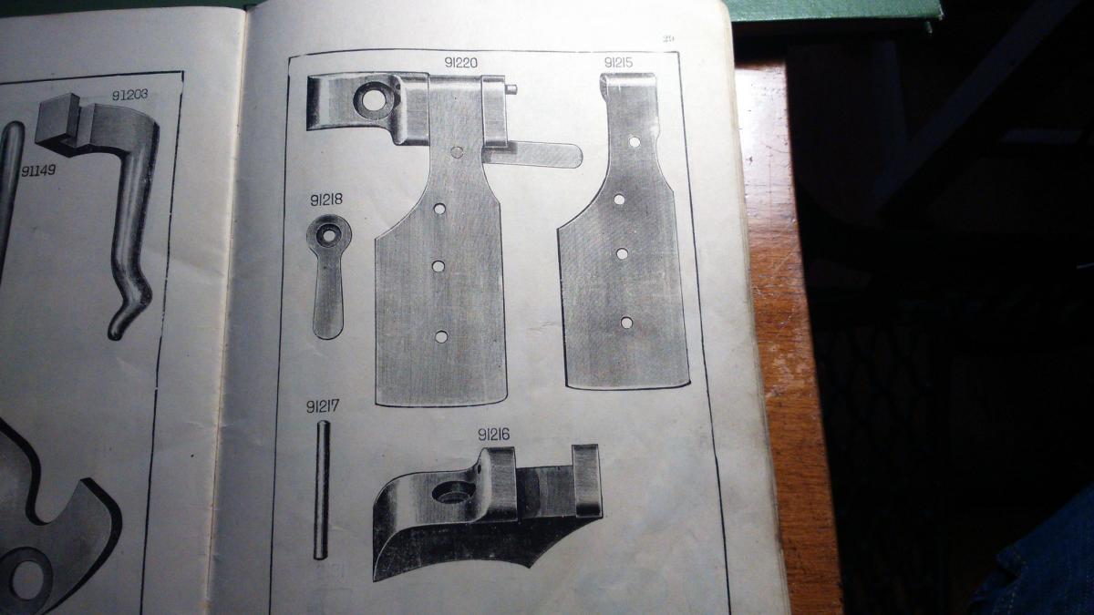

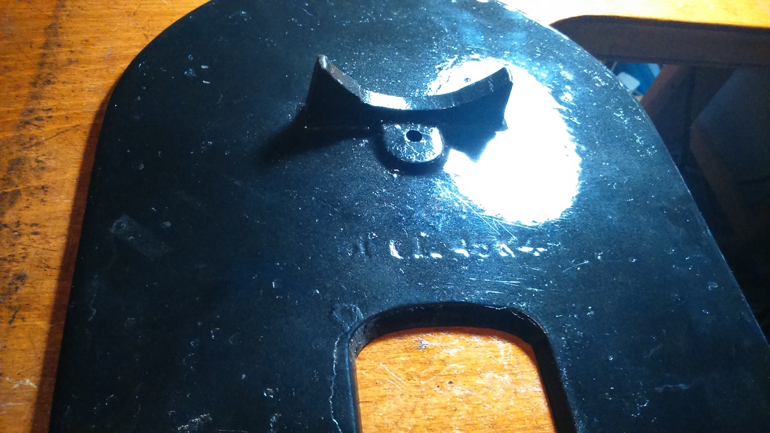

Here is an idea if you needed a flat surface for sewing. If you look on the bottom of the page with the description of the 45ks it says that work plates were supplied at extra cost. they have the nº 91261-45k48 stamped on the underside. they were cast iron but you could even make a wooden one, only thing you would need is the screw to hold it on with. it is the same screw that holds the wax pot on which i see you dont have present. also your balance wheel is on back to front??

Oh so i bought the work plate from you foker lol! Evo, yes the machine came in this condition and with the treadle included, it only needed to be threaded and oiled. and the decals are original. if you look up the documentery called "the birth of a sewing machine" it is taken in the singer factory in killbowie and at one point you see how they were put on the machines and at another point you see them being made in sheets. that looks like gold leaf they were made of, looks similar to the way you would book bind with gold leaf, stamped/pressed? maybe constabulary can give us a little info on his flaky ones lol? are they made of gold leaf folker?? Good luck with finding the oil box and bobbin winder Evo, remember to get all the screws that go with them if you can. if you are handy with your tools you can make these parts up. i ended up making 5 plates and 3 feed dogs up from some steel plate. for your machine you need to get someone to curve it. i looked for some 6mm steel pipe with the aprox radius then got them to bend the thinner plate over this and made up the plates i needed. first thing is to square up your plate and get your two screw holes in the right place, screw it on and then put in a new needle and mark your needle hole. for your feed dog opening you can either use your old plate or scale up a picture from a parts manual. these were drawn to scale and are good for references (i dont think they are exact). http://dixiesewingmachine.tzo.com/MANUALS/SINGERPARTS2/45K21,%2045K25,%2045K63,%20&%2045K78.pdf.

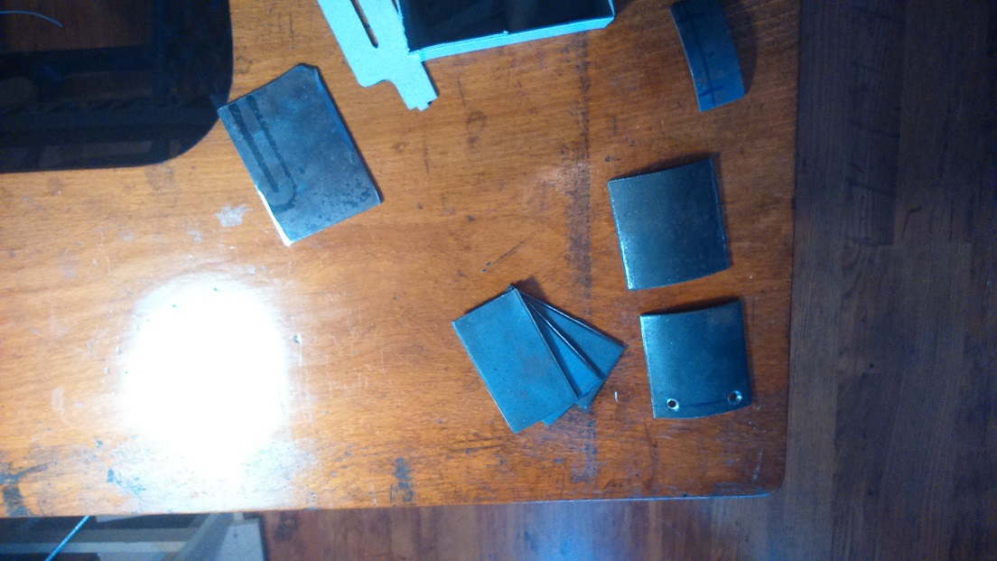

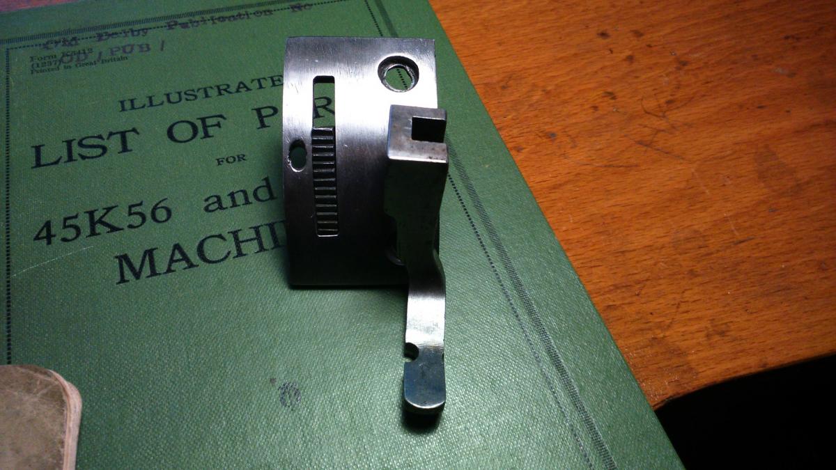

if your feed dog is original then i would try to file the teeth nearly to a point again, remember you need a good file as they were hardened. the hardest part was the feed dog as this needs to be grinded little by little and the screw hole needs to be milled flat bottom not with a bevel like with a normal drill. i done mine with a small 9mm milling bit in the drill, first with the 9-10mm hss drill then with the milling bit. you can do this in your pillar drill. the two holes on the plate need to be finished the same. otherwise if you find the same thread type on other screws with the bevel head then just change them. Drill out the bulk then fine adjust with a file. here are a coulpe of examles:
Posted (edited)

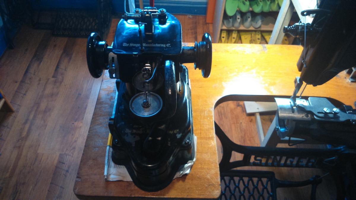

post-32832-0-20493000-1416667172_thumb.jpost-32832-0-63422900-1416667184_thumb.jpost-32832-0-52231400-1416667213_thumb.jpost-32832-0-51207700-1416667231_thumb.j
the alternative swing fence was made from the measurements of the drawing. the needle plate and feed dog were also made for the right toe foot which came with the machine.
look for these screws if you are looking for your oil box:post-32832-0-05175200-1416667667_thumb.jpost-32832-0-60471100-1416667696_thumb.j

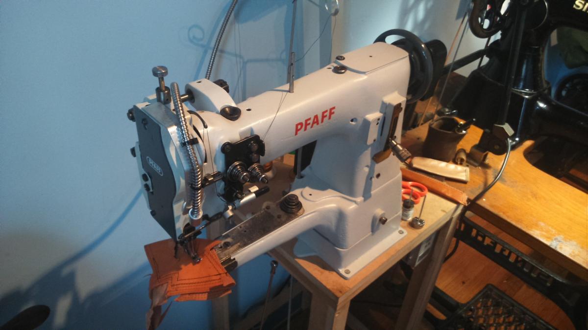

Evo, you can see the process for the restoration of the pfaff in the last two pictures in another topic called "journey to the unknown".post-32832-0-47965600-1416667961_thumb.jpost-32832-0-50068900-1416667974_thumb.jpost-32832-0-10196000-1416667987_thumb.jpost-32832-0-78150500-1416667996_thumb.jpost-32832-0-03805500-1416668006_thumb.jpost-32832-0-44001100-1416668029_thumb.jpost-32832-0-82330400-1416668043_thumb.j

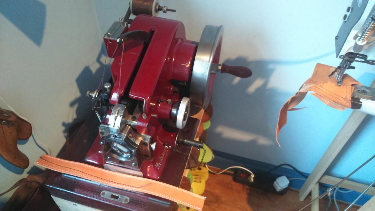

Evo this is the machine that was fully restored, the pfaff not the frobana. thanks again to folker for being able to aquire the tension unit.
The frobana is for sewing soles on shoes or sandals etc..
We are going to make some sandals first. we made sandals about 20yrs ago by hand but now its the machines turn to do the stitching lol. first i need to know a little the machine, then shoes?? who knows?
