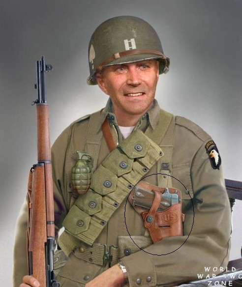

camano ridge Report post Posted November 23, 2014 Are you refering to this style snap? Quote Share this post Link to post Share on other sites
BigMack1990 Report post Posted November 23, 2014 Yes, the top snap. Not sure where to find them or if they are even made anymore. Quote Share this post Link to post Share on other sites
camano ridge Report post Posted November 23, 2014 Yes they are still available. THey are Lift the-Dot 4 piece fastners. They are manufactured by the Dot company. THe easiest place to find them is if there is a Marine/boat supply place near you. Ordering on line most require a minimum order of 100 and sell the pieces individualy. I found a place on ebay that sells a five pack of all 4 pieces for $15.00 http://www.ebay.com/itm/Lift-The-Dot-Stud-Socket-w-Backing-Plates-Black-Oxide-5-Piece-/221312158480?pt=Boat_Parts_Accessories_Gear&hash=item33873b8b10&vxp=mtr The issue holster had them either government Black or brass. Either is period correct. Quote Share this post Link to post Share on other sites
