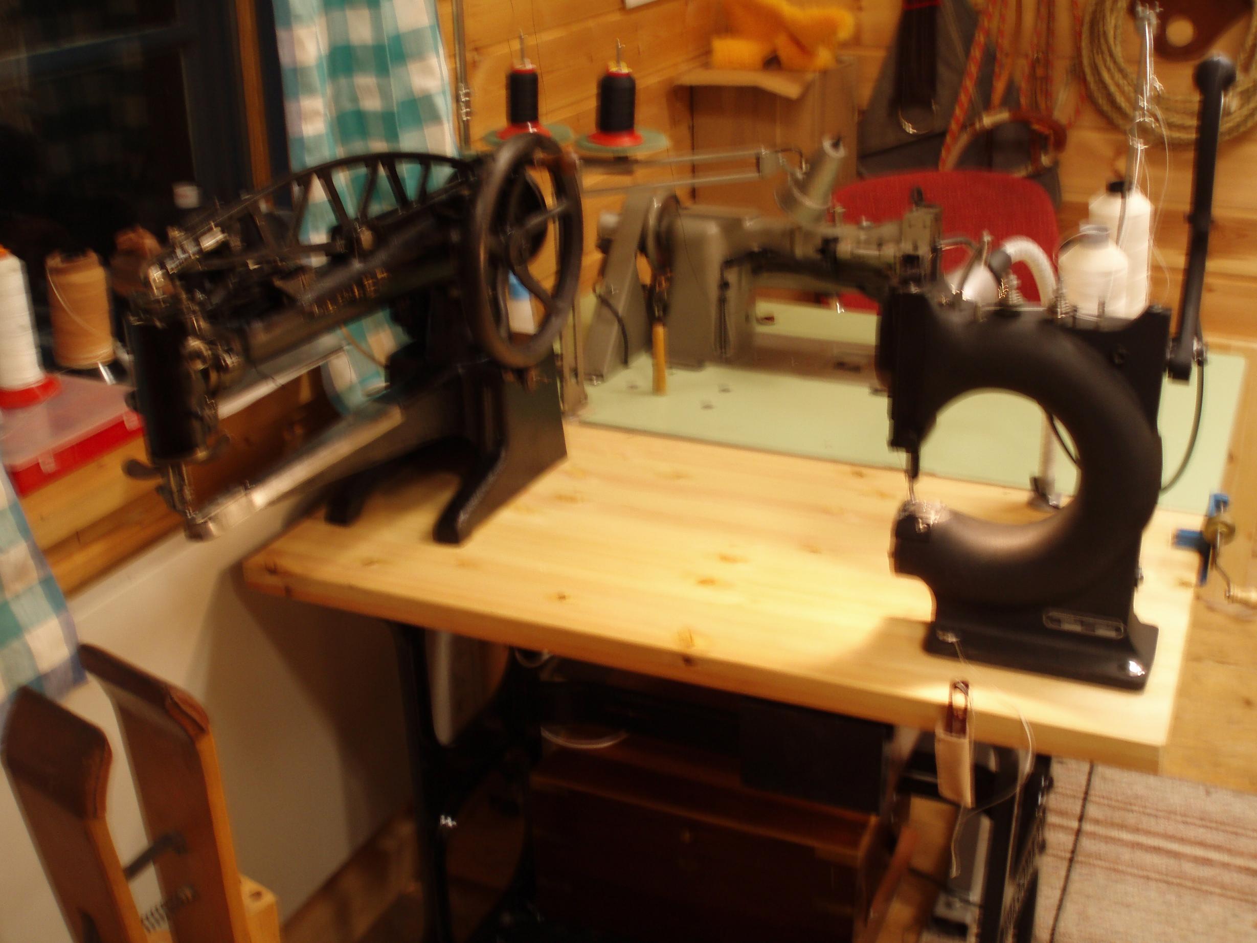

Members oldtimer Posted November 16, 2008 Members Report Posted November 16, 2008 I got so inspired so I just had to make me a new bench for my Boss. To save space in my shop I also mounted my Adler 30-1 on the same bench. I had an old cast iron sewing machine stand which I cleaned up and painted, and made a new table top out of pine boards. I also made a flatbed attachment of wood for the Boss but I have already found improvements to do. I use my stitching horse as a chair when using the Boss and Adler. Quote "The gun fight at the O.K. corral was actually started by two saddlemakers sitting around a bottle of whiskey talking about saddle fitting"...
