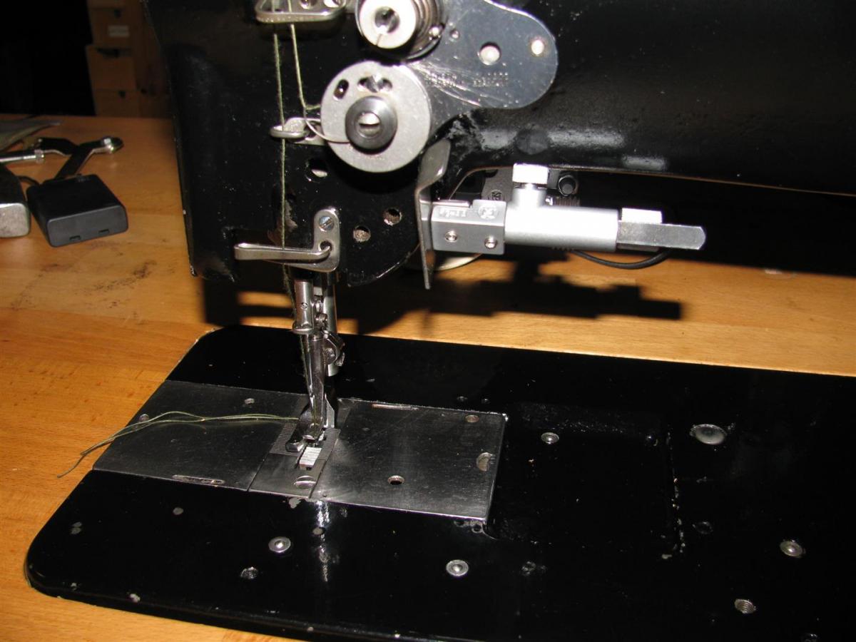

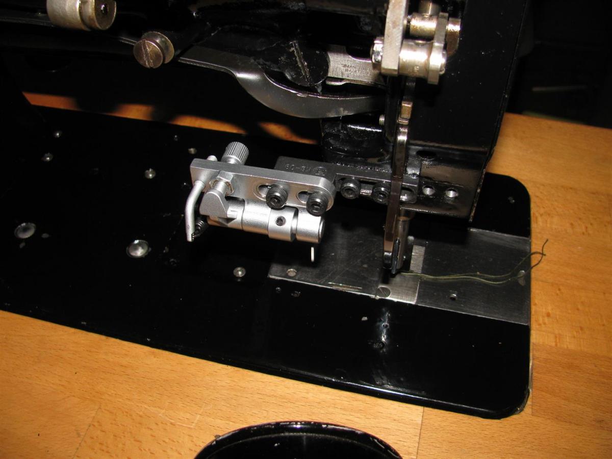

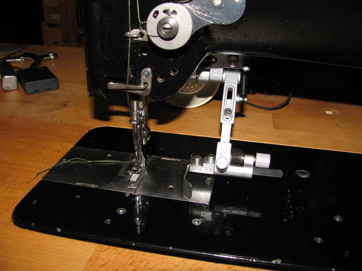

Members Constabulary Posted January 14, 2015 Members Report Posted January 14, 2015 (edited) $69? Is it just the roller guide or does it come with plate? I have a flip down edge guide on my 111G156. It comes with interchangebale guide tips - one straight and one roller guide. It will fit your 153 as well but you have to drill some holes. You can find them on Ebay, College Sewing and so forth. MIne is from College Sewing and works great. Very versatile and I´m sure it will fit most other industrial machines as well. https://www.college-sewing.co.uk/KG1245-DROP-GUIDE-PFAFF-1245,1246,1525,1526,335,591 http://www.ebay.com/itm/Suspending-Edge-Guide-for-Industrial-Walking-Foot-Sewing-Machine-Juki-Consew-GB-/181638866413?pt=LH_DefaultDomain_0&hash=item2a4a8525ed www.kwokhing.com is another source but I don´t know if they still sell to end consumers. Edited January 14, 2015 by Constabulary Quote
Members MuddyClearWaters Posted January 16, 2015 Author Members Report Posted January 16, 2015 $69? Is it just the roller guide or does it come with plate? I have a flip down edge guide on my 111G156. It comes with interchangebale guide tips - one straight and one roller guide. It will fit your 153 as well but you have to drill some holes. IMG_7816.JPGIMG_7817.JPGIMG_7814.JPG You can find them on Ebay, College Sewing and so forth. MIne is from College Sewing and works great. Very versatile and I´m sure it will fit most other industrial machines as well. https://www.college-sewing.co.uk/KG1245-DROP-GUIDE-PFAFF-1245,1246,1525,1526,335,591 http://www.ebay.com/itm/Suspending-Edge-Guide-for-Industrial-Walking-Foot-Sewing-Machine-Juki-Consew-GB-/181638866413?pt=LH_DefaultDomain_0&hash=item2a4a8525ed www.kwokhing.com is another source but I don´t know if they still sell to end consumers. hmmmm that might be good. Quote
