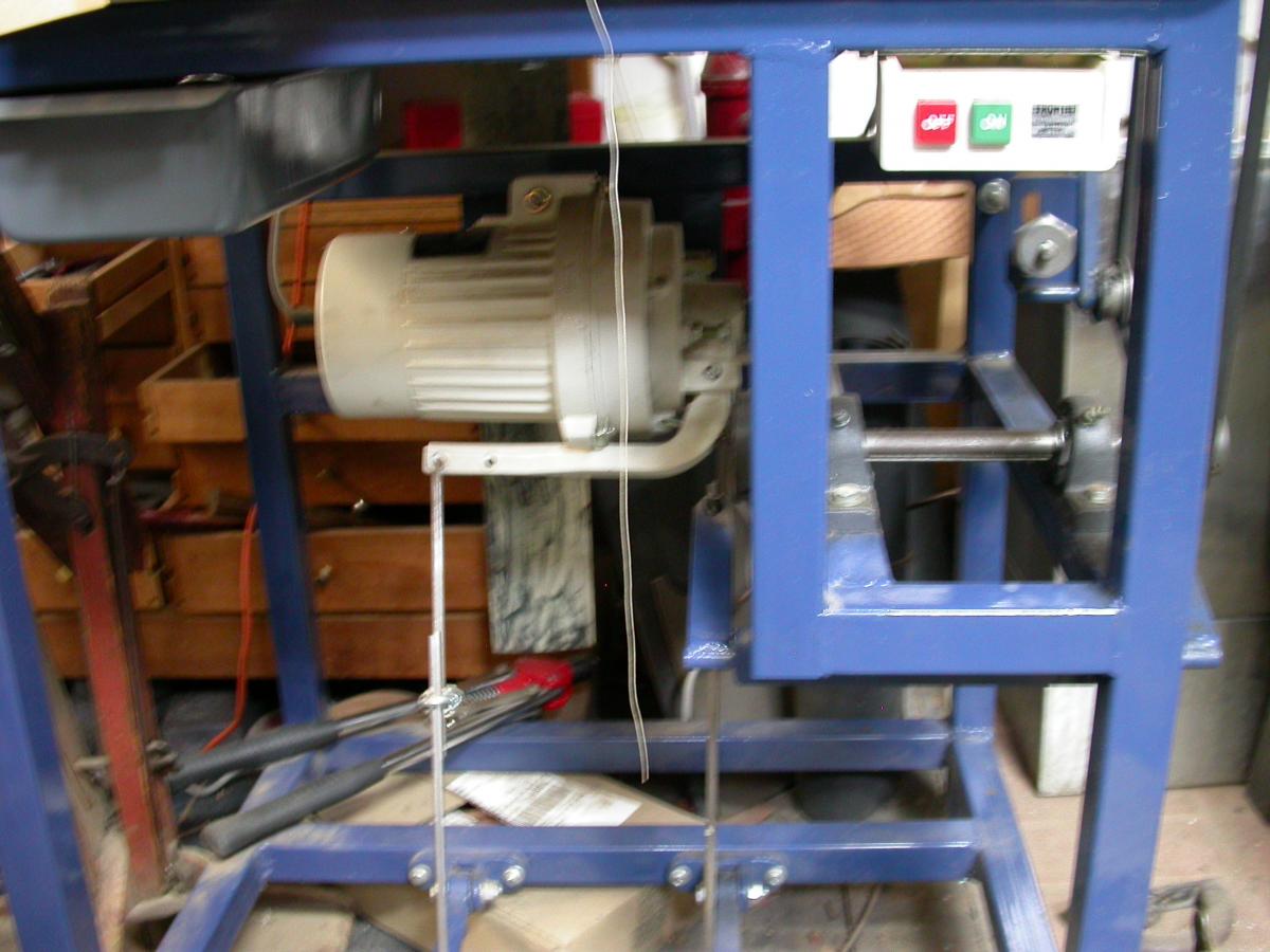

Members steadybrook Posted January 9, 2015 Members Report Posted January 9, 2015 Is anyone using a servo motor on their needle / awl machines ? If so, does it allow you to stitch one stitch at a time? And what size motor are you using? Quote

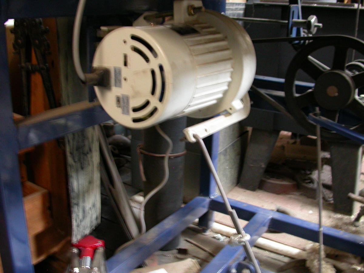

Members steadybrook Posted January 10, 2015 Author Members Report Posted January 10, 2015 Thanks, I would like to see the pictures. Here is my set up now with the clutch motor. Quote
CowboyBob Posted January 10, 2015 Report Posted January 10, 2015 James, Clutchmotors have a feature where you can turn the end & have the clutch arm any direction you want it,if you put a servo on your machine the mounting bracket needs to be horizontal instead of verticle like your is because the arm isn't adjustable on the servos. It probably wouldn't be to hard to make a different mounting bracket. Quote Bob Kovar Toledo Industrial Sewing Machine Sales Ltd. 3631 Marine Rd Toledo,Ohio 43609 1-866-362-7397
