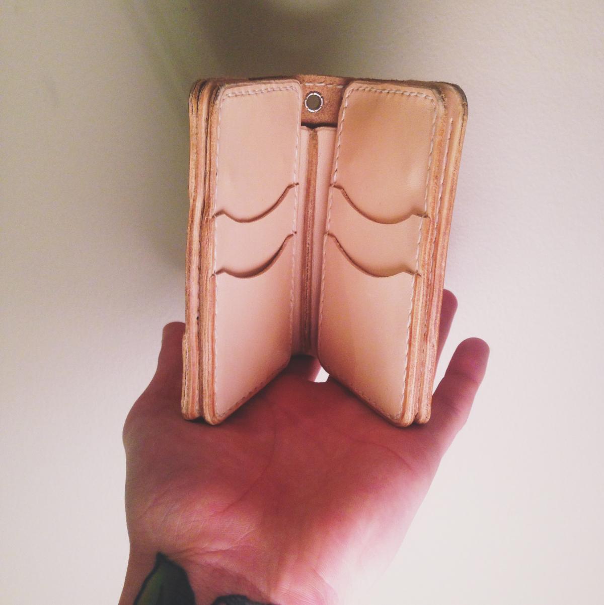

Hi!
I am new at this forum. Started making wallets for myself almost two years ago, but this is the first wallet I have made for a customer. Quite happy with the result, but it's really thick. Does anyone have any suggestions on how I could slim it down a bit - other than the obvious, using a thinner leather..? Especially the cardholders, as I use four layers. There might be some topics of this other places on the forum, but I haven't really had time to check it out. Anyways, hope you like it :)
/Torgrim
Looks pretty good, thinner leather will work as you already mentioned --- I would also spend some time burnishing and finishing the edges...
~Tramp~
Experientia magistra stultorum --- (Experience is the teacher of fools)
I agree with Tramp. Other than that it looks pretty good. Stitching looks nice.
Rohn
(John 8:32) And ye shall know the truth, and the truth shall make you free. (KJV)
Looks like a fine wallet. Your customer will be happy.
As far as making it thinner could always skive the leather down.
You'll need to make the card slot pieces shape like a "T", as in notch the sides and stack them that way... kind of hard to explain without photos but there are threads on the topic within the forum. This way your pockets are all one layer of leather.
Aside from that, nice job!
