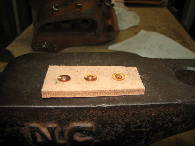

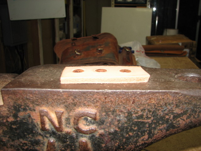

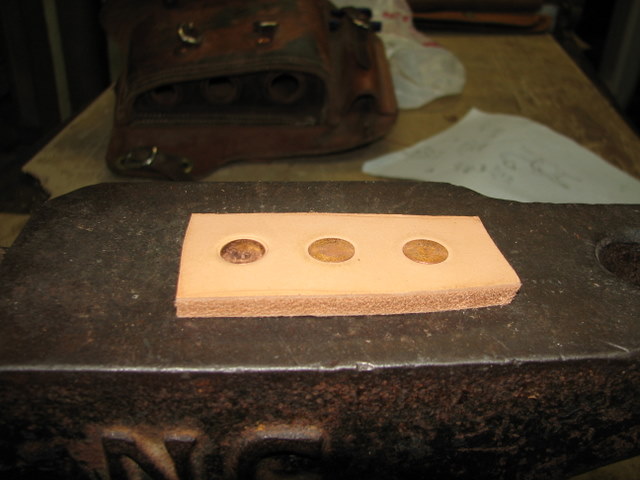

Moderator bruce johnson Posted November 13, 2008 Moderator Report Posted November 13, 2008 Richard, Here are some pics of a scrap with some rivets in it. The one on the right is set by hand and peened with a hammer. The middle is set with Bob's peening tool, but the head wasn't domed from the other side. It makes a nice rounded smooth peen. The one on the left was set with the peening tool and then turned over and the head domed. Doming the head after setting the peen will flatten top of the peen a bit and countersink it some. You can also predome them by setting it into a punched piece of scrap, and letting the shank sit down in the pritchel hole of the anvil and dome it. Then when you set the burr, it stays rounded up more if you like that look or effect. I get less scraping by flattening and countersinking it a bit. Quote Bruce Johnson Malachi 4:2 "the windshield's bigger than the mirror, somewhere west of Laramie" - Dave Stamey Vintage Refurbished And Selected New Leather Tools For Sale - www.brucejohnsonleather.com
