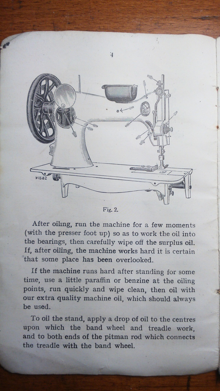

Hi Everyone, if you have a singer class 45k sewing machine then you will know how difficult it is to find an Original users manual for this class of machine. Either they were all burned? or someone has a big stash of them somewhere??. I have finally come across one which was in between a few other manuals and would like to share with you 45k users as i know how difficult it is to get your hands on one. i cant get it up in PDF (too big) so you will have to do this yourself afterwards. I will also add some more information regarding the class 45k machines which i managed to find in the past couple of years. feel free to add any other information regarding this machine to this topic as this kind of information should not be kept in a drawer.

Great information! Really helpful.
Thank you Jimi.
Posted (edited)
WOW - thats the first complete Singer 45K instructions manual I have ever seen!!!
Great find Jimi :specool:

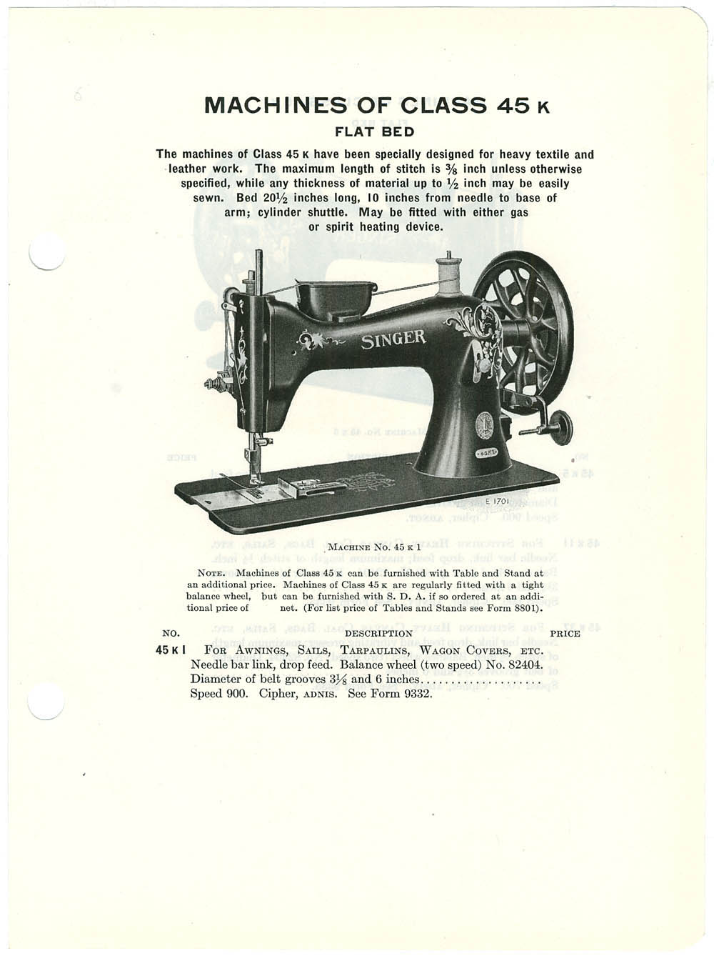

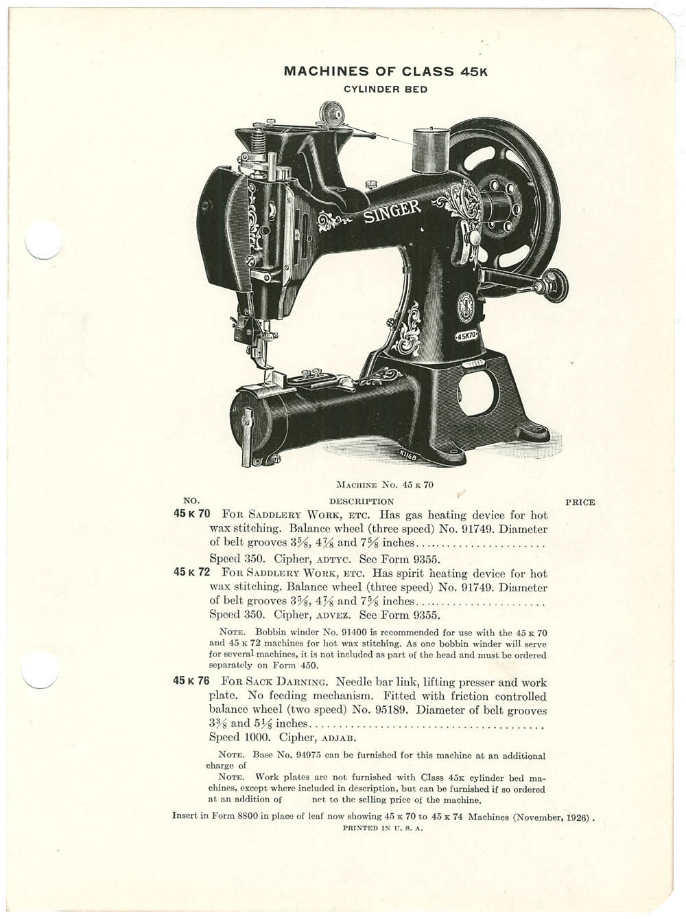

Here are some more pages from an older book.
post-32832-0-64765100-1424389708_thumb.jpost-32832-0-03864900-1424389720_thumb.jpost-32832-0-46303000-1424389734_thumb.jpost-32832-0-21580700-1424389746_thumb.j
post-32832-0-14507600-1424389803_thumb.jpost-32832-0-22792700-1424389816_thumb.jpost-32832-0-57295700-1424389832_thumb.jpost-32832-0-06128400-1424389850_thumb.jpost-32832-0-86978800-1424389867_thumb.j
post-32832-0-24718300-1424389926_thumb.jpost-32832-0-47883700-1424389941_thumb.jpost-32832-0-35796700-1424389955_thumb.j
post-32832-0-08739600-1424390014_thumb.jpost-32832-0-10693700-1424390029_thumb.jpost-32832-0-02192300-1424390041_thumb.j
Curious to see decals on the base, the square work table and the double row of teeth feed dog on the 45k21 page. also you can see that the bobbin winder is a one piece arm and not yet an articulated one.
