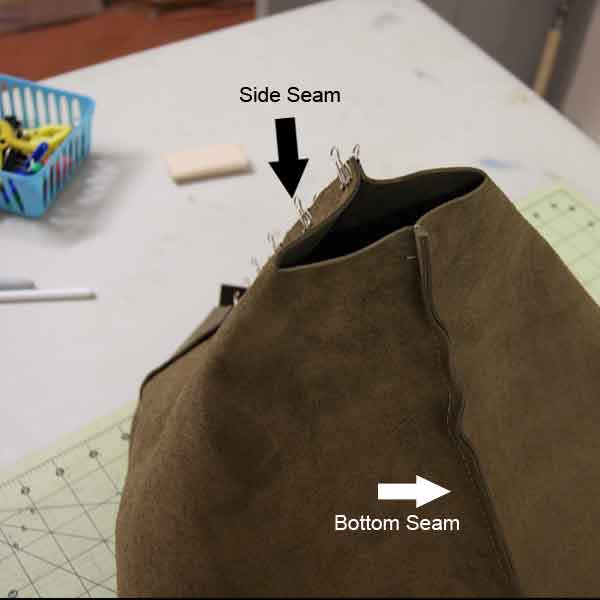

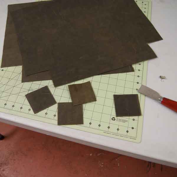

Okay here are some photos so that hopefully you can get a better idea. I am going to do this with two pieces of leather like in the video.
First lay the pattern out on the leather and cut out the pattern. (This bag will be approximately 16"W, 14"H x 5"D)

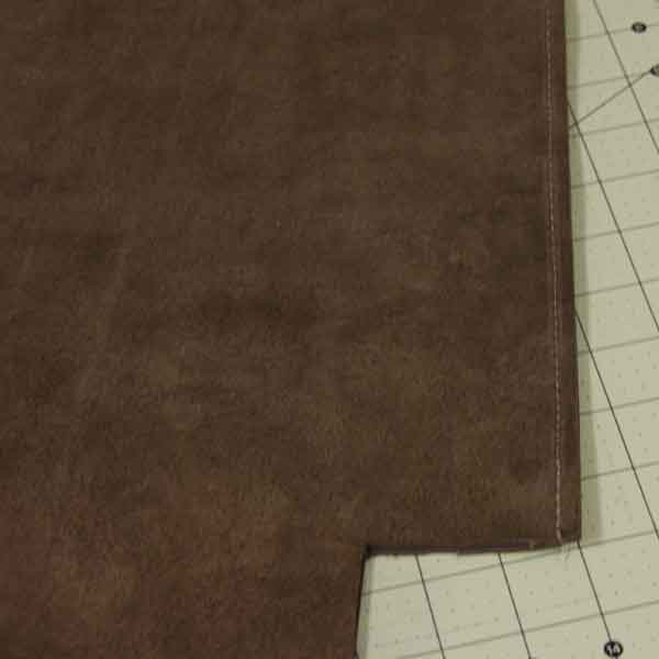

Place the two pieces so that the exterior is facing each other and sew across the bottom as you usually would remembering to back stich a few times to lock the stitch in.
post-32363-0-77053500-1426866681_thumb.j post-32363-0-16276000-1426866958_thumb.j
Next sew down the sides of the bag remembering to back stitch a few times to lock the stitch in.
post-32363-0-81272300-1426867045_thumb.j
(I didn't sew down the side of this bag because I still need to sew on a zippered pouch on the front and a pouch inside, so I need the bag open to do that, but you will still clearly see what has to be done to complete the bag.)

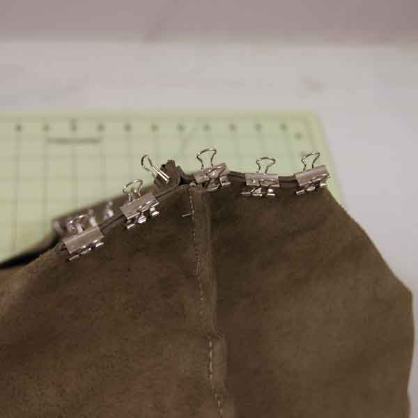

OK position the bag like this and pinch the two sides closed.
post-32363-0-23034300-1426867242_thumb.j post-32363-0-63353600-1426867332_thumb.j
A close up of the bag when the bottom and sides are pinched together and ready to sew.
post-32363-0-02148500-1426868404_thumb.j
