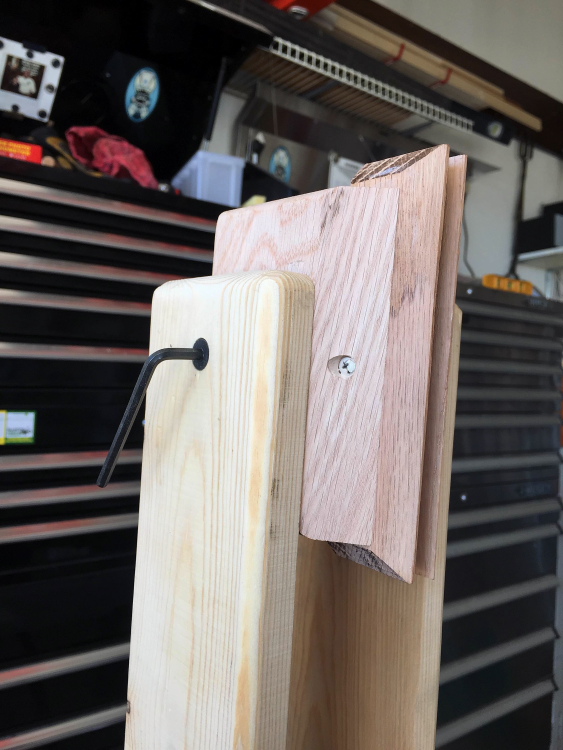

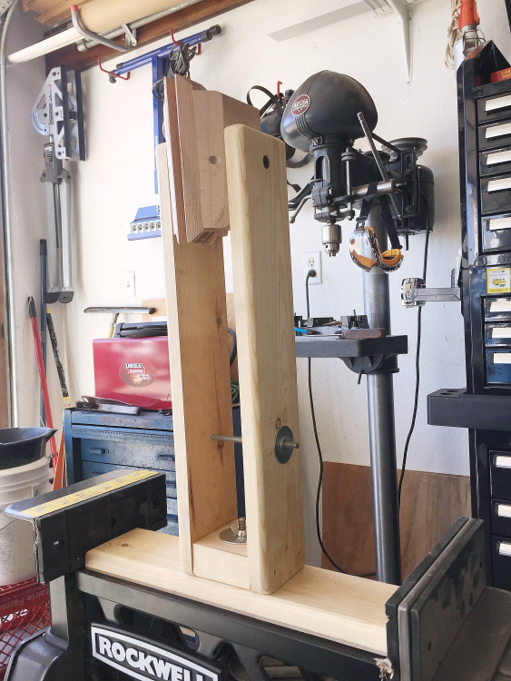

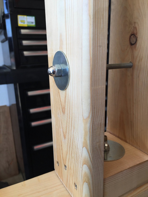

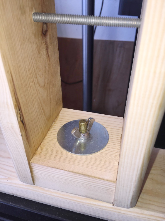

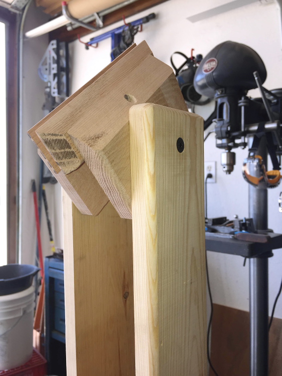

Mark Peters Posted April 5, 2015 Report Posted April 5, 2015 (edited) More complicated than I thought it would be,but after a couple of failed attempts, I came up with this one that I think will do the job. Still need to attach leather to the clamp faces, and waiting for the cam lever clamps to arrive from Rockler. Pine for the base and legs, oak for the clamp heads which are 6 inches wide. The heads use flush mount allen head screws into 1/4 x 20 t-nuts to allow for rotation. The base swivel is an old brass toilet seat screw (very thin head) as I didn't want to recess the base too much. Edited April 5, 2015 by Mark Peters Quote

Members veedub3 Posted April 5, 2015 Members Report Posted April 5, 2015 That tilt feature is a nice addition. I was thinking of making another one that sits on the floor and I hold with my feet as opposed to the one that you sit on so that I can tilt/angle the piece when sewing but the tilt feature seems like a easier idea. Hope you don't mind me stealing your idea. Karina Quote
