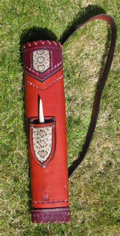

Members bushpilotmexico Posted April 8, 2015 Members Report Posted April 8, 2015 I have searched all over including this forum for hints on how to fasten rawhide between two pieces of leather when forming a fast draw cowboy holster. I Googled one gentleman who makes them and when it came to his process he politely said it's a trade secret. I'm a custom knife maker and in all my years never met a knifemaker who wouldn't share any or all the information he possessed. Nothing was a trade secret. The thing that separated the master knife makers from the amateur was the quality of the finished product. I make all the sheaths for my knives as well as archery quivers. Rawhide has to be wet to be formed, seems like glue won't adhere to a wet surface, the rawhide shrinks when it dries, if you sandwich it between two layers it will shrink and possibly bubble up the liner and on and on, lots of horror stories. It would be much appreciated if anyone be able to tell me how to proceed or maybe give me some helpful tips? I use 8-9 oz leather for my sheaths and for holster making was thinking of using 8-9 oz and then 3-4 oz for the liner and sandwiching rawhide in between. Some photos: Quote

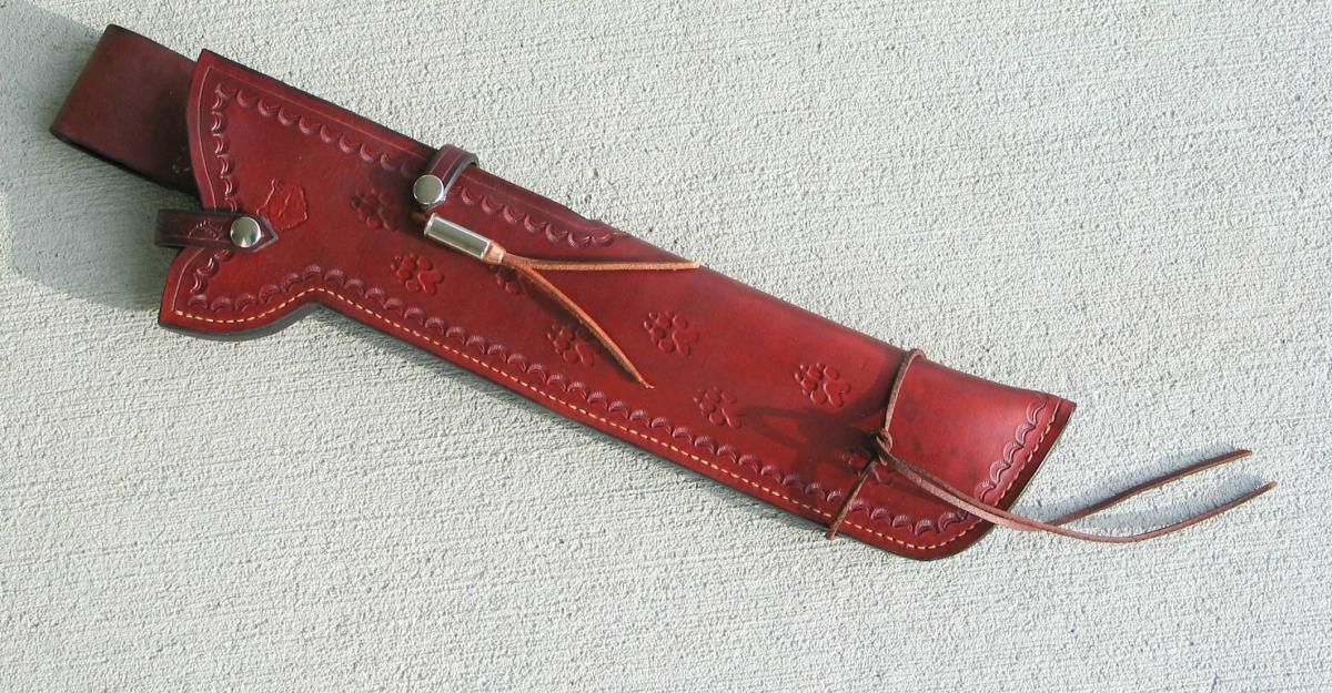

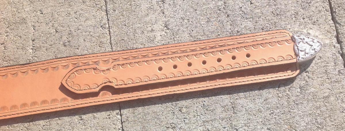

Members Dwight Posted April 8, 2015 Members Report Posted April 8, 2015 My one and only rawhide project was a knife sheath, . . . for a special, . . . home made knife for a young man who wanted a Native American look. The photo is that sheath, . . . I took a piece of rawhide, . . . wet it, . . . formed the "general" shape of what i was wanting by wetting and bending it. A few days later when I was certain it had dried, . . . I contact cemented it to the suede that makes the sheath. Haven't heard any complaints, . . . and that was several years ago. May God bless, Dwight Quote If you can breathe, . . . thank God. If you can read, . . . thank a teacher. If you are reading this in English, . . . thank a veteran. www.dwightsgunleather.com

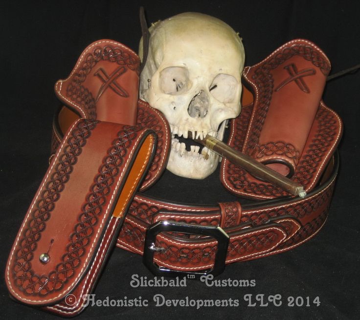

Members Red Cent Posted April 11, 2015 Members Report Posted April 11, 2015 (edited) BTW, this guy is known for his rawhide uses. He built these. Those dark strips top and bottom are rawhide. However, they are on the outside of the holsters. http://www.rodkiblersaddlery.com/ Edited April 11, 2015 by Red Cent Quote https://www.facebook.com/redcentcustomleather?ref=bookmarks http://www.redcentcustomleather.com/
