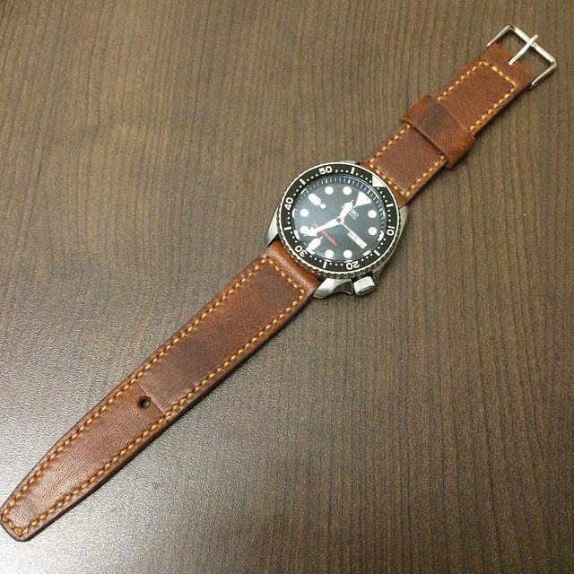

Members iWERKS Posted April 15, 2015 Members Report Posted April 15, 2015 (edited) I just started out making my own straps about a month ago (and still have lots to learn). I've been using leather in the 4-6oz range, double layered so that the strap is approx 4-6mm thick. It really depends on the watch it's going on and if it thick strap matches it. For buckles, I like to use either the OEM buckle that came with the watch, or something a bit less common. I found this ratcheting divers clasp at strapcode.com which I'm using on the Breitling. They sell many other style of buckles but they're not exactly cheap. Here's a few i've made Edited April 15, 2015 by iWERKS Quote

Members iWERKS Posted April 15, 2015 Members Report Posted April 15, 2015 Thanks ramrod. My obsession with watches and leather straps is what led me here. I put three holes in my straps because usually the first hole I punch is either too big or to small lol and having two holes looks odd. Being pretty new at this, I was afraid if I put more than three holes, they will start to get out of alignment/spacing. Get my "plan B" logic? The Makara is CUSN8 bronze. Great watch for the price. Photos really can't illustrate how light emphasizes the hexagonal shape of the case for a split second when the light hits it at the right angle. Quote

Members ramrod Posted April 17, 2015 Members Report Posted April 17, 2015 (edited) The Makara is CUSN8 bronze. LOL...i'm such an idiot (bangs head on desk). that's actually what i meant. seems there are more bronze watches on the market lately. it's on my list. thanks for that buckle link, jwallace. i've been looking for a site to buy some. sweet! a seiko diver. are you on the SCWF site? Edited April 17, 2015 by ramrod Quote
