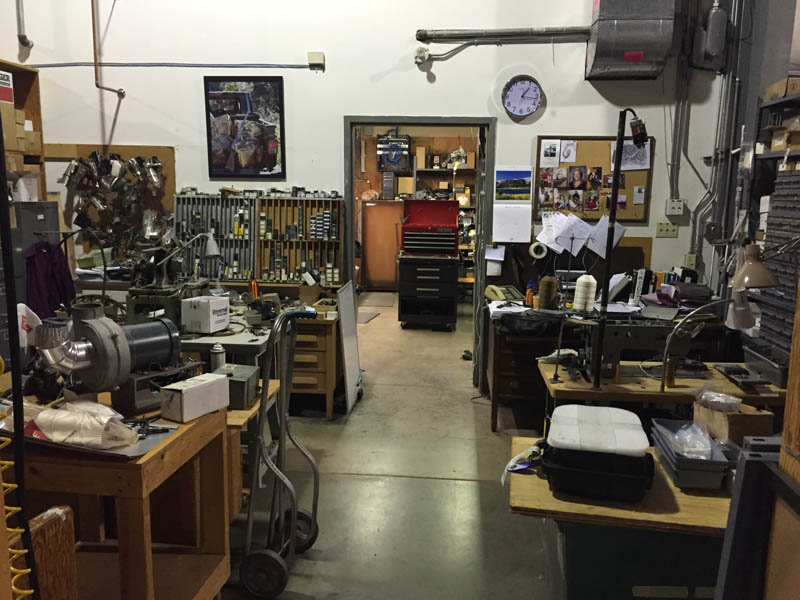

Members Constabulary Posted May 17, 2015 Members Report Posted May 17, 2015 I´d also love being in your shop when nobody is there. I´m sure I will discoverer some interesting things. Quote ~ Keep "OLD CAST IRON" alive - it´s worth it ~ Machines in use: - Singer 111G156 - Singer 307G2 - Singer 29K71 - Singer 212G141 - Singer 45D91 - Singer 132K6 - Singer 108W20 - Singer 51WSV2 - Singer 143W2

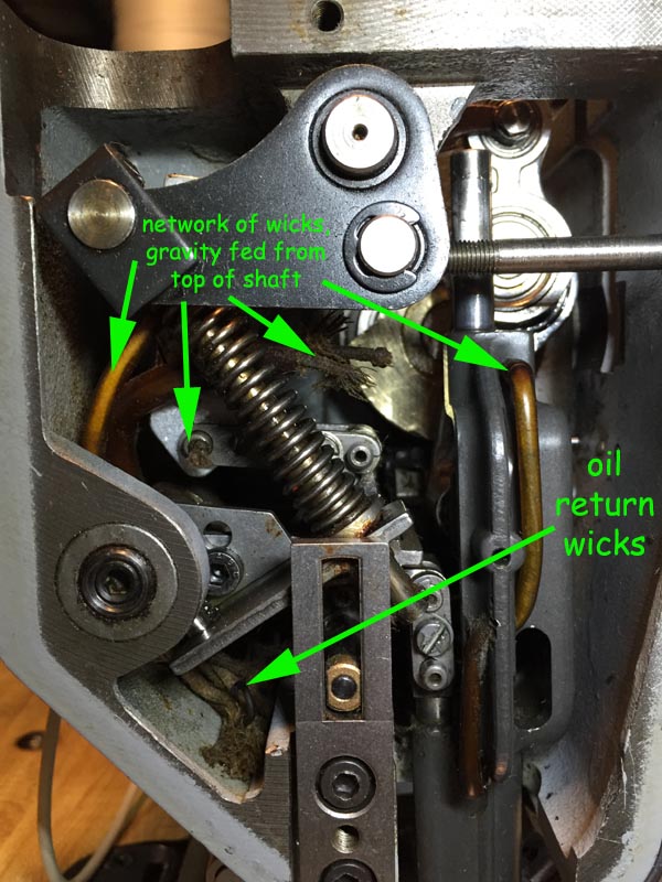

Members gottaknow Posted May 22, 2015 Author Members Report Posted May 22, 2015 So today, I mapped out the required locations for oil on the top shaft, and the end of the head where the needle bar resides. I removed most of the wicks that were fed from the failed shaft pump. Because the end of the head was oiled from those wicks, gravity will carry oil back to them. I spent some time thinking about the best way to oil this part of the machine. I kept coming back to something Singer stood by going way back. If you manually oil the critical parts each day you use the machine, there's nothing to fail. It also ensures that if a long time goes between use, gravity won't drain everything and there's no pump to fail or under perform at slow speed. The top cover of this machine lends itself to some strategic small oil holes, painted red. That was Singers universal language for "oil here". It also gives the next owner the ability to oil the machine without an explanation. The return oil wicks will still take care of any over-oiling issues. Sometimes the simplest ways are the best. No covers will have to be removed since the end of the machine will be fed from the top. I also figured out today that the break in the top oiling system, (sight glass area) came before the contamination of the lower oil sump. There is no rust on that end of the machine. If there were, this machine may be a total loss, depending on the extent of the pitting. What's left is drilling and painting the new holes, flushing the lower sump one more time, and more test sewing to make sure things are good still. Oh, I still have to make a new tension unit for the bobbin winder. The bad news is the lower shaft seals will continue to leak and the timing belt worries me because of the oil. It will be up to the owner to try and keep it wiped clean. It would be interesting to price out all the new components to rebuild the oil system the way it once was. I have done that on certain specialty machines, but your average industrial isn't worth the expense or labor. To get this machine back to original would require removing most of the larger shafts. With the pitting, some would have to be replaced. Of course it would be fun, but not cost effective. Regards, Eric Quote

Members gottaknow Posted June 13, 2015 Author Members Report Posted June 13, 2015 I've been able to find time to drill holes in the top cover so this machine can be kept oiled. I'll follow up with pictures when I can. I've been spending a fair amount of time in our Seattle factories in the past few weeks. I still need to smooth up the holes and paint them. After that's all done I can put everything back together and do the final sew off. It's been quite the process. Oh, I'll do another oil change too. Regards, Eric Quote

Members gottaknow Posted July 16, 2015 Author Members Report Posted July 16, 2015 Hi stranger. It seems the longer I tinker with your machine, the better it's getting. I'm in our Seattle factory this week, but when I get back I'll post some pics of my latest sewing. It's sewing two ply of 8-9 oz. bridle leather with no skipping or thread breakage. It could really use a new hook, but I'm not sure I'd invest the money in that. As for the oil, the holes are all drilled in the right places and I've oiled it to see if I have dry spots after sewing. Before I send it back, I want to have done enough sewing to give you an accurate, honest evaluation. At this point, I believe the machine is usable and will produce a nice stitch. I've been using T135 bonded nylon top and bottom with a size 22 needle. It seems to like that combination. I put some T208 through it which it didn't like that well. I hope to get you some pics this weekend. I've been traveling every week for the last 6 weeks, mainly training the handful of mechanics we have. Regards, Eric Quote
