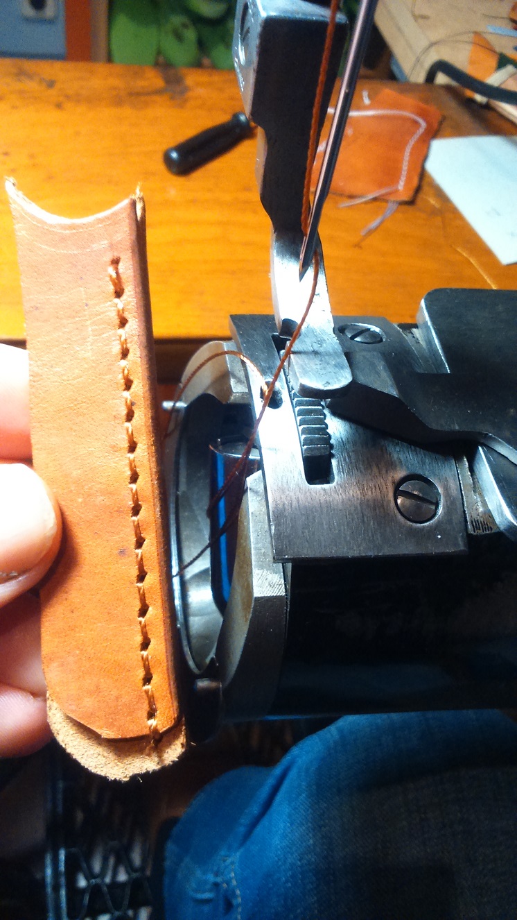

Members jimi Posted April 29, 2015 Members Report Posted April 29, 2015 Hi There, what are you planning on sewing?? i think you are looking for something like a cowboy CB-4500. or like constabulary said, a pearson which is similar to a luberto. (not the smaller classic) or an adler 105 with needle feed. the 45k on a treadle will sew what goes under the foot (about 12mm) but it has no needle feed and will mark your leather underneath. check out this video. Quote
Members Europeanleather Posted April 30, 2015 Author Members Report Posted April 30, 2015 Canvas duffle bags, leather wallets and the occasional leather bags are what I'm stitching, mostly chrome tan leathers or canvas materials. Is there a way to prevent the 45k from scratching the underside of the leather? Im interested in vintage manual machines because they seem less complicated to use, the singer 29k is perfect with its rotating feature but the needle and bobbin are too small. Are there any heavier duty singer 29k alternatives? Junker and run machine looks like it is too heavy duty for what I'm doing. For shoes it looks perfect though. Quote
Members jimi Posted May 1, 2015 Members Report Posted May 1, 2015 Here are a couple of options. http://leatherworker.net/forum/index.php?showtopic=61619&page=3 the other option is to use a worn feed dog and rub out the marks.I think chrome tan marks less than veg tan. for sewing wallets i reckon a walking foot machine would be better. i have done a few wallets using a pfaff 335 and they worked out very well. you can also do binding on them, so that could be a good option for the canvas bag??, but dont expect it to take 12mm thick leather! Quote
