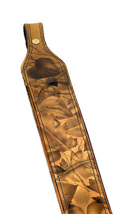

JLSleather Report post Posted May 4, 2015 (edited) True that COULD be done with an airbrush (or a paint brush, for that matter). Still, takes a good while to get much effect, but handy if you just need ONE (not a whole side of it). Edited May 4, 2015 by JLSleather Quote Share this post Link to post Share on other sites
kaerkes Report post Posted May 5, 2015 absolut amazing result jlsleather! Quote Share this post Link to post Share on other sites
JLSleather Report post Posted May 5, 2015 On 5/5/2015 at 2:11 PM, kaerkes said: absolut amazing result jlsleather! That's a simple rifle sling, done with two shades of brown and an airbrush. Glad you like it, but honestly -- not that difficult Quote Share this post Link to post Share on other sites
