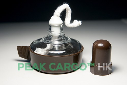

Members Tannin Posted May 22, 2015 Author Members Report Posted May 22, 2015 (edited) Anybody use one of those glass jeweler's spirit lamps (~£8 on ebay) that have angled sides so that you can lean them over (and/or perhaps so they are stable & safe if they fall over)? Is that a useful feature? Or the very cheap, simple £3 Chinese ones from ebay (or the £8 Japanese variant). Anybody use one those shiny metal (stainless steel?) dental spirit lamps (~£6-£8 on ebay/Amazon)? One model just has one hole/cap with wick. Another has a second cap (vent/filler?). Is wick adjusting wheel worthwile or just an unnecessary gimmick? Anybody tried one of the vintage medical/dental tool sterilizing burners? They often take the fold of a rectangular box with a foldout lid. Often they have a flip-up tool holder - presumably to support the tool handle away from the flame while the tip is steralized - which seems like a handy feature. Some are sold as expensive antiques but I have seen a couple of cheap ones. How do you support the tool when heating it - do you just hold it? When I used my woodburner, I just propped the handle up on a log which sat on the stove top & let the head sit on the stove top. Edited May 22, 2015 by Tannin Quote

Members Tannin Posted May 22, 2015 Author Members Report Posted May 22, 2015 (edited) Ah, so it was not Graham Kerr - just a coincidence that we re-discovered both at the same time in Seattle! My apologies to all. (I just put a strike line through that bit of my earlier post to avoid future confusion.) BTW This is the kind of thing I meant by "Dental spirit burner": And this is the glass jeweler's variety mentioned: The v. cheap (£3) HK version: The "Japan" version (used in schools?): Vintage medical/military sterilizing (with tool-holder - possibly for sterlizing syringe needles?): Edited May 22, 2015 by Tannin Quote
