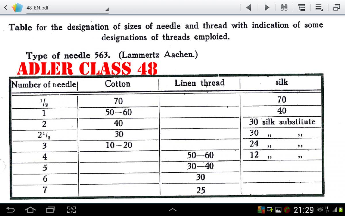

http://www.duerkopp-adler.com/export/sites/duerkoppadler/commons/download/public/48/48_EN.pdf
Page 9
