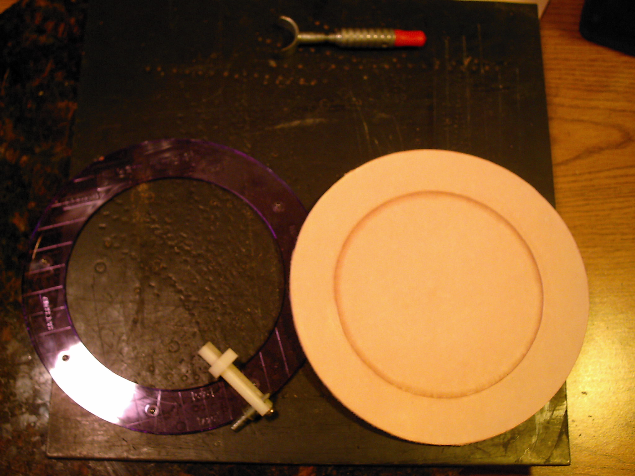

Members CitizenKate Posted November 27, 2008 Members Report Posted November 27, 2008 My usual method of cutting a circle (like for a coaster) is to use a pair of dividers to scribe the circle into the leather, then cut it out in one pass with a heavy-duty Xacto knife. If the knife is kept sharp, it will cut easily through fairly heavy leather in one pass. To keep the dividers from poking a hole in the center of the circle, I use another small bit of leather to protect the piece I'm cutting on. Some people will advocate the use of a round knife - that is probably better if you have one and know how to use it safely. If you don't mind a hole in the center, you can cut a perfect circle by nailing down a piece of leather, poking your knife through the leather at the desired radius, then just turn the leather while holding the blade stationary. When the leather has turned 360 deg., you have a perfectly cut circle. If all else fails, and you plan to cut a lot of circles, you can have a cutting die made. A die as simple as this can be made fairly inexpensively. If you don't have a press, you can just tap the die into the leather to cut the part with a mallet. Kate Quote

Contributing Member UKRay Posted November 27, 2008 Contributing Member Report Posted November 27, 2008 (edited) Washer cutters are a great idea, Tom - here is a picture to show you what the two sorts look like. I have a double washer cutter and it works really well - best of all you can slip the second blade out and use it for simple circles. It does leave a 'dimple' in the centre of the leather though - but I always find a reason to wack that with an embossing stamp LOL. Edited November 27, 2008 by UKRay Quote "Some mornings, it's just not worth chewing through the leather straps" Ray Hatley www.barefootleather.co.uk

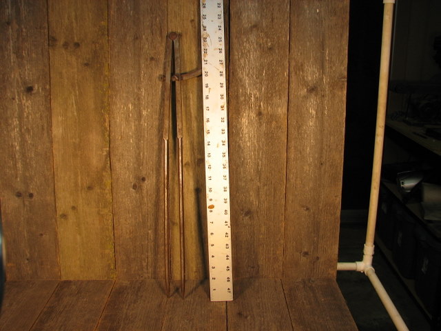

Moderator bruce johnson Posted November 27, 2008 Moderator Report Posted November 27, 2008 Tom, I do a lot of stuff with big circles. My biggest problem was always getting a good circle on big stuff. We go to a lot of antique stores and one of the things we collect are things marked "Johnson" - Old Johnson Wax containers, Johnson fishing reels, Johnson soda bottles, etc. A couple months ago we went into a shop, and the lady told me right off the bat she had just got in a tool marked "Johnson" that I might want. I about tipped over when I saw a set of 24" Wm Johnson Newark NJ dividers - $7. Before that I used the string and nail deal to make big patterns. Smaller things I use pans, bowls, stencils, whatever fits. Quote Bruce Johnson Malachi 4:2 "the windshield's bigger than the mirror, somewhere west of Laramie" - Dave Stamey Vintage Refurbished And Selected New Leather Tools For Sale - www.brucejohnsonleather.com
