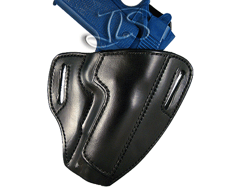

Contributing Member JLSleather Posted August 23, 2015 Author Contributing Member Report Posted August 23, 2015 (edited) FREE 1911 5-inch pancake style holster pattern now available. NO curved slots http://www.jlsleather.com/diy/holster-diy/ Oh, yeah.. it makes this one.. Edited August 23, 2015 by JLSleather Quote "Observation is 9/10 of the law." IF what you do is something that ANYBODY can do, then don't be surprised when ANYBODY does.
