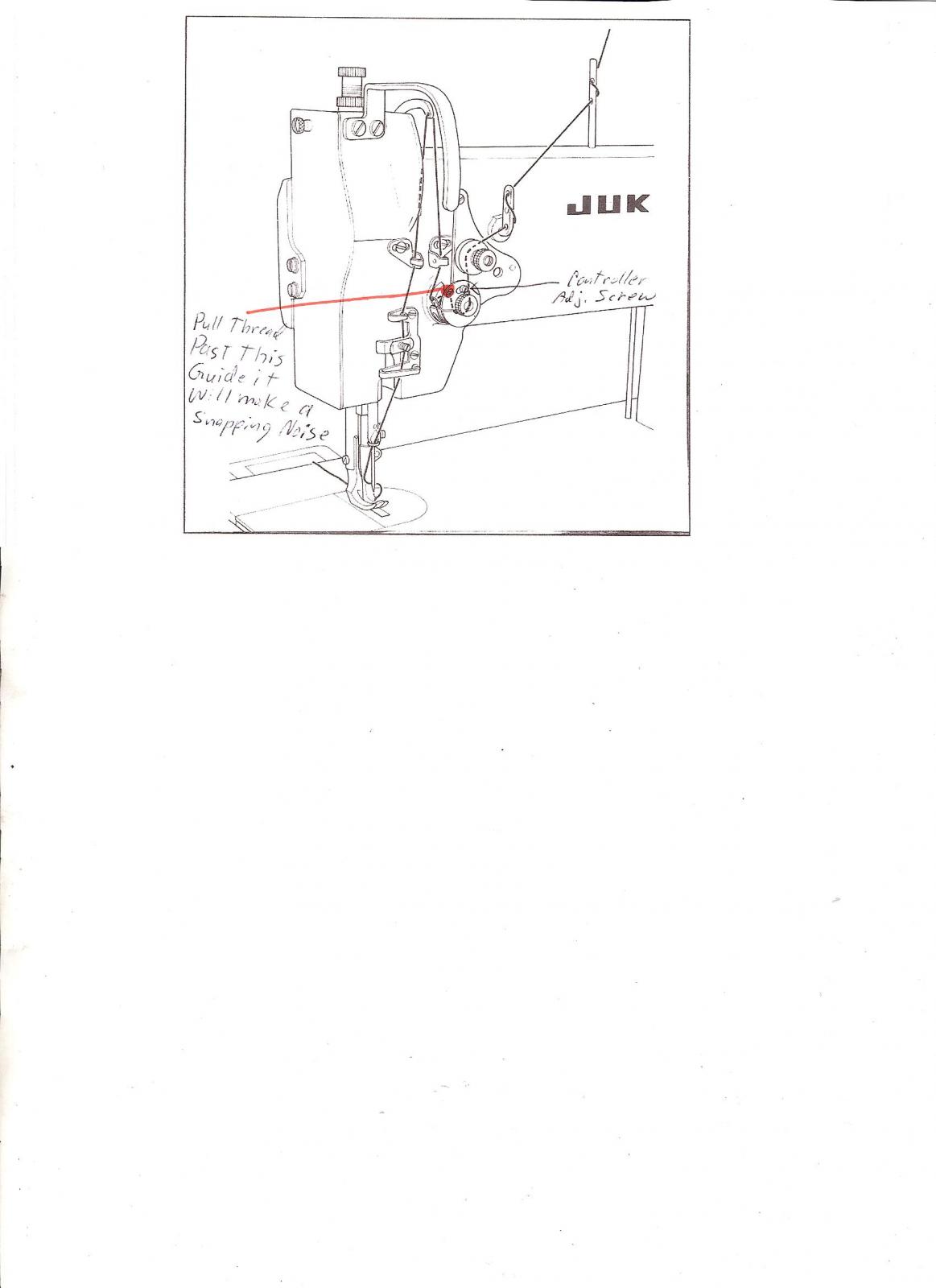

CowboyBob Posted September 19, 2015 Report Posted September 19, 2015 On any machne when it is looping on the bottom either your thread isn't threaded correctly OR the upper thread tension is too loose. It sounds like maybe it's too tight right now because you say when it goes all the way in the tension it breaks.That is where it IS supposed to be all the way in it.So maybe loosen it one turn,pull it all the way in & see what happens. See attached threading chart. Quote Bob Kovar Toledo Industrial Sewing Machine Sales Ltd. 3631 Marine Rd Toledo,Ohio 43609 1-866-362-7397
Members stickandtin Posted September 19, 2015 Author Members Report Posted September 19, 2015 CowboyBob- You hit the nail on the head. Thread tensioner was too tight. Backed it off and ran several test stitches and examined the tightness of the stitches after each run. Adjusted the tensioner between each pass until the stitches looked good and tight. Thanks for the help and advice. 25b, my bad....thread is size 69 on a 1/2 lb spool. Actually my wife started learning to sew when she was 4, she is now 50. The problem isn't her not knowing how to sew, it's learning the ins and outs of this industrial machine. She has never used a machine like this. Thanks for the help!! Quote
