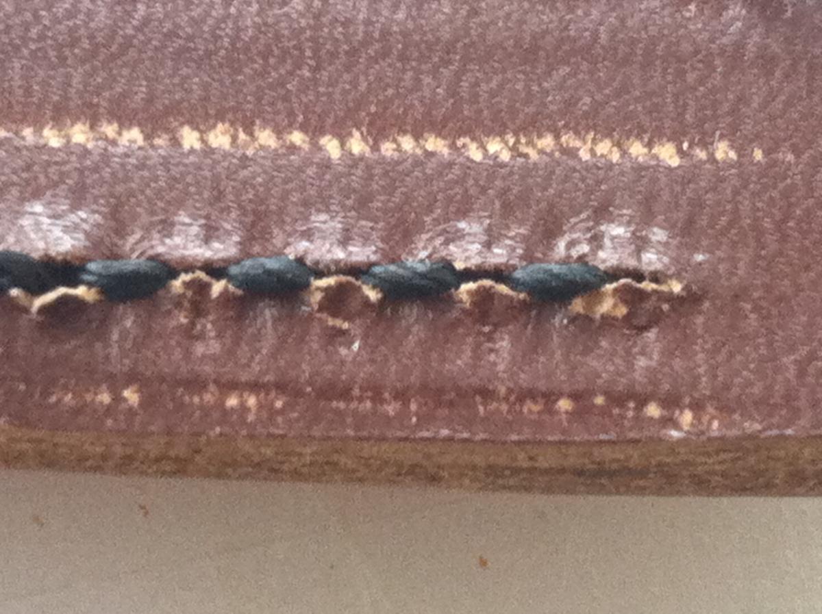

Members llucas Posted November 24, 2015 Author Members Report Posted November 24, 2015 (edited) Thanks for the info, Uwe. The plate, feed dog and walking feet on this machine are pretty rough. Here are a few photos. Edited November 24, 2015 by llucas Quote

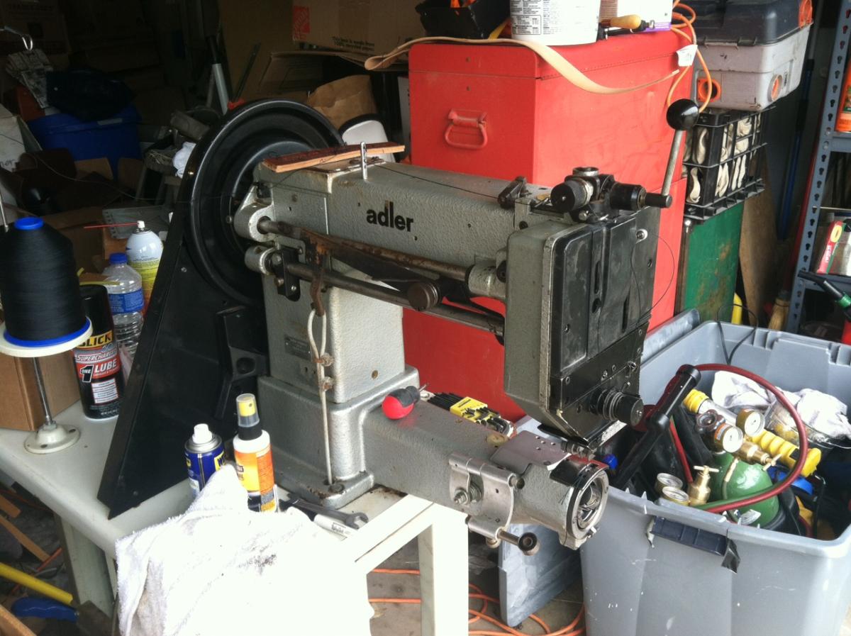

Members llucas Posted November 24, 2015 Author Members Report Posted November 24, 2015 (edited) Here is the beastie. Believe it or not, this is AFTER I cleaned it up, lol: Edited November 24, 2015 by llucas Quote

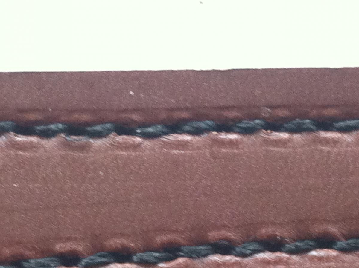

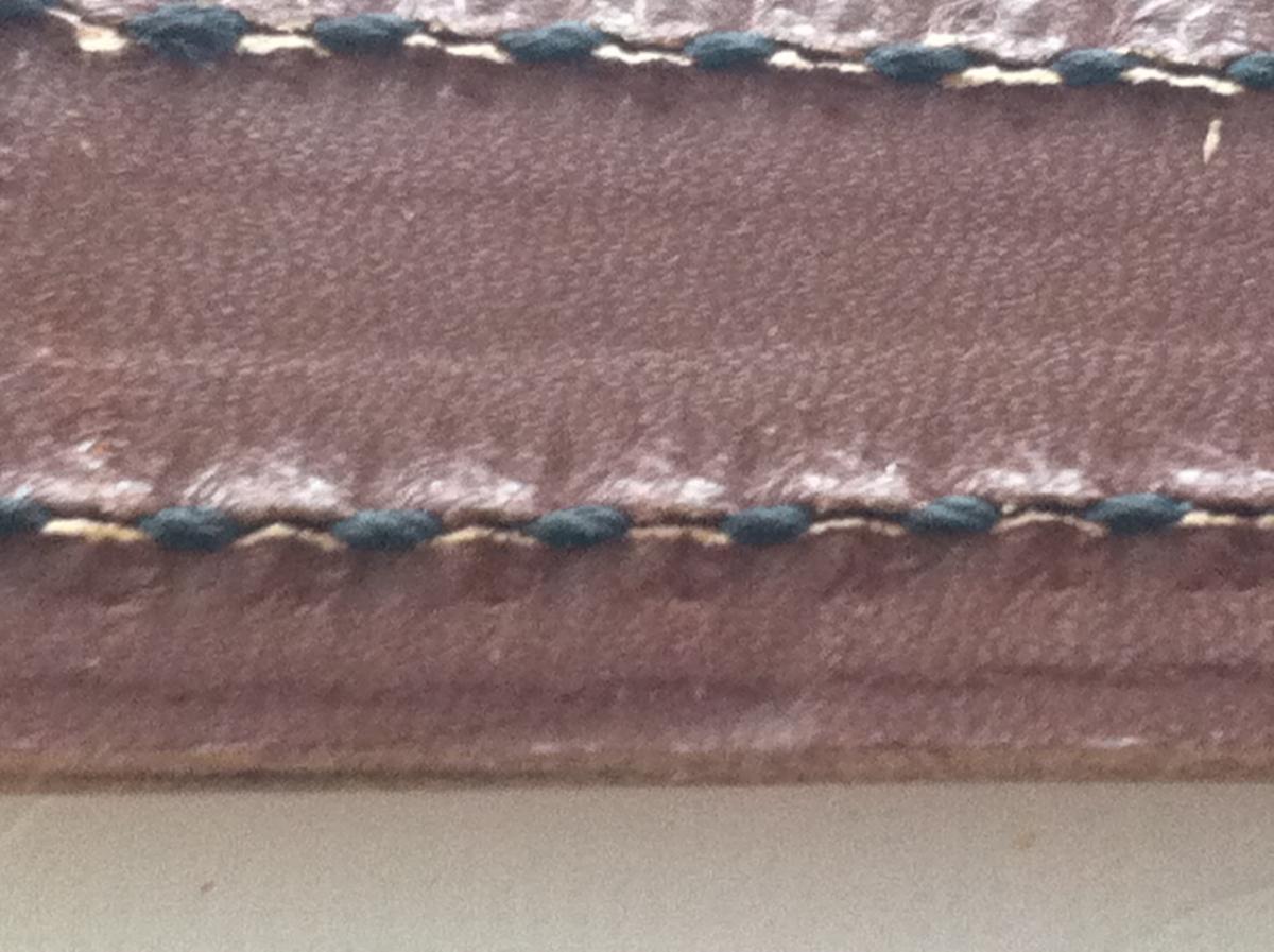

Members llucas Posted February 2, 2016 Author Members Report Posted February 2, 2016 (edited) Ok, as a complete novice to leather sewing machines and stitching leather with them, I am learning far more about this Adler 205-374 than I ever wanted to know, lol. I installed the repaired parts (feed dog carrier and the unchanged cam) from Weaver and adjusted the end thrust of the cam to where the needle guard was in the right place in relationship to the needle and the needle to the shuttle hook. I managed to get it timed per service manual specs. Now I am facing an issue that was not there before: while sewing the stitch length changes. For about six to ten stitches it runs about four stitches per inch then changes to five stitches per inch, and occasionally six stitches per inch. to me as a novice it seems the tension is right as it buries the knot in the middle of the leather. Could the tension be too tight, even if "balanced"? The stitch looks good on the top except for the change in stitch length. The bottom stitch not so much. There is another new problem that was not there before the repair: when I reverse to backstitch the stitch length doubles. It hits the holes but goes to every other one. I am using 346 nylon on the top and 277 nylon in the bobbin. The thread is also from Weaver and is new. It seems to be much better thread than I was using before. No problems with fraying or coming apart. There is an adjustment for the 205 series wherein the middle foot is adjusted to the average thickness of material being sewn -- I have not attempted that one yet. The pressure on the double foot is adjusted to a modest pressure -- does it need more pressure? Is the leather slipping under the feet? If it is slipping, wouldn't there be greater inconsistency between the length of the stitches instead of five to six inches where the length is the same? Suggestions? Here is the top stitch about 4 per inch, also showing back stitching skipping every other hole This is the top stitch showing changed length. The groove was intentional and meant to be a stitching groove that I missed, lol. Here is the stitching on the back showing the start and the reverse backstitching: This is the back showing the change in stitch length: The back doesn't look as good as the top, and I am not sure why it is fracturing the leather where the needle punches through. It is older leather -- or does the needle need to be changed? I am grateful for the help I have received on this forum. Edited February 2, 2016 by llucas Quote
Uwe Posted February 2, 2016 Report Posted February 2, 2016 (edited) Does the Twilight Zone Theme play while this is all happening? That exact double stitch length in reverse is just too freaky. Make a video of that. The only real explanation of that would be a stitch length mechanism that's WAY out of adjustment. Is your feed dog movement correct after re-installing the cam? Check feed dog movements without any material and verify they make sense, both forward and reverse. Test sew a piece with NO thread, forward and reverse. If stitch length still changes it's clearly not the thread that's causing it. Does the material slip a little when the needle is above the material? That's the only time it really can slip. Perhaps the outer presser foot is not holding the material down with enough force to keep it from slipping. Thread tension does play into this to some degree. If thread tension is too high it may yank the material towards the needle a little as it's pulling the knot tight and pulls more thread from the spool. If the material is not slipping, perhaps the transport mechanism or linkage is slipping when the going gets tough or reverses. Make sure all the screws and bolts involved in the stitch length mechanism are tight. Does the stitch length lever move when this happens? That level should stay wherever you put it and it should not move as you sew. Edited February 2, 2016 by Uwe Quote
Members llucas Posted February 2, 2016 Author Members Report Posted February 2, 2016 (edited) Thanks Uwe. Today was the first day it was up and running after the repair. I wondered about the outer presser foot pressure -- in the first two photos you'll notice there are no marks from the outer presser foot, whereas most of the photo samples I have seen on leatherworker.net have at least mild impressions. The feet on this machine are harness-makers feet and I assumed I would have to buy smooth and bigger feet to minimize that issue. So I was happy today when it made no marks. I'll put more pressure on the outer presser foot tomorrow and see if it helps. Perhaps it is slipping in conjunction with the thread tension. I have had a hard time observing the actual mechanics while sewing samples as I still have a clutch motor that speeds up beyond my ability to sew (servo and speed reducer pulley will be my next purchase). But I will try to be more observant and report what I see. I did check the only screw on the stitch length lever I could see and it seems firm. Edited February 2, 2016 by llucas Quote
Uwe Posted February 2, 2016 Report Posted February 2, 2016 Just turn it over by hand to make stitches until you figure out what's going on. When I make major changes or adjustments I always check everything out first with hand-turned stitches before I even attempt to run it under power. A lot of bad things can happen under motor power that won't happen if you first turn the wheel by hand and observe, listen and feel how the machine works. Quote
