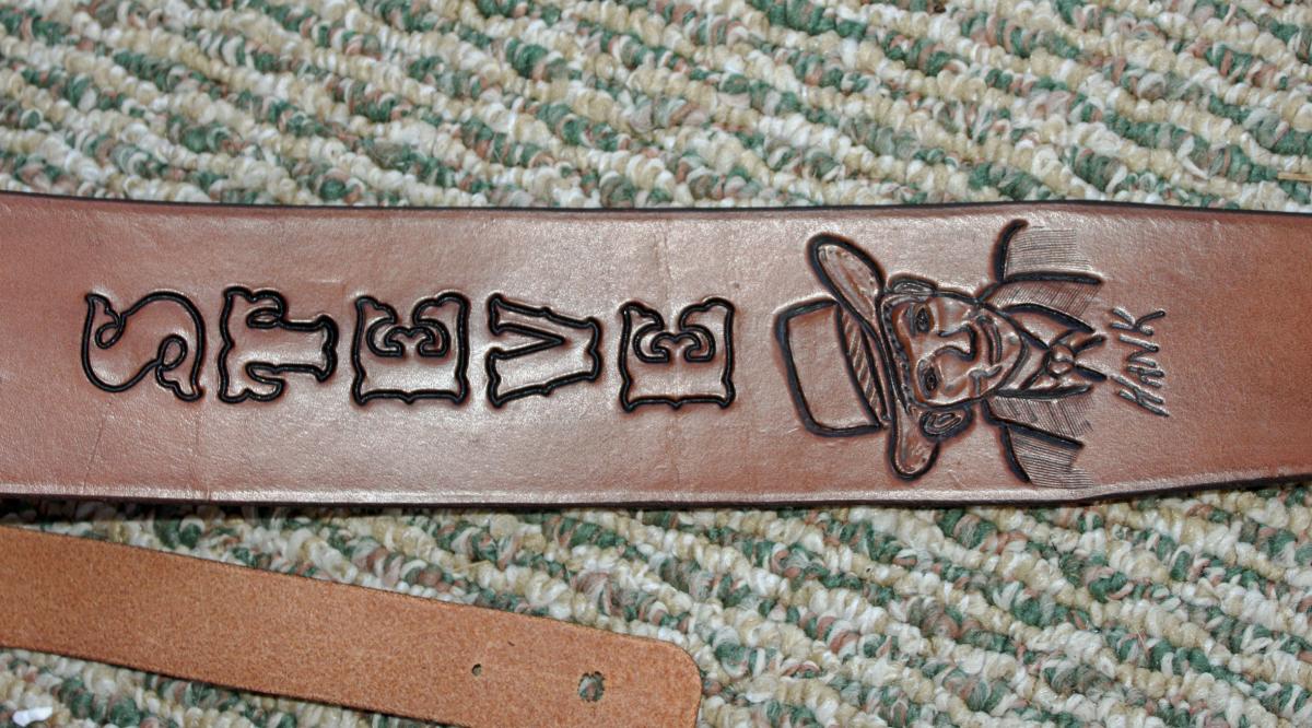

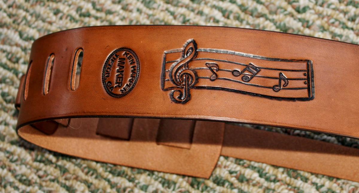

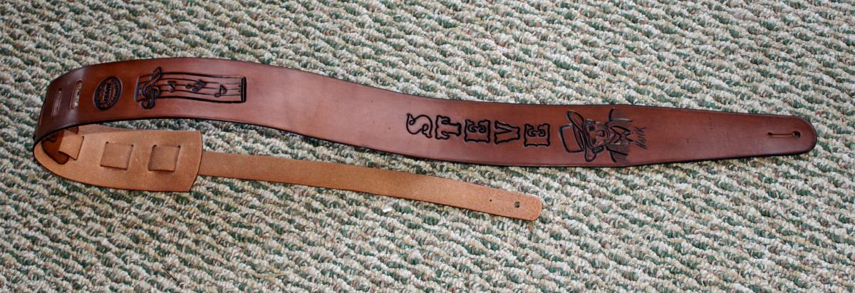

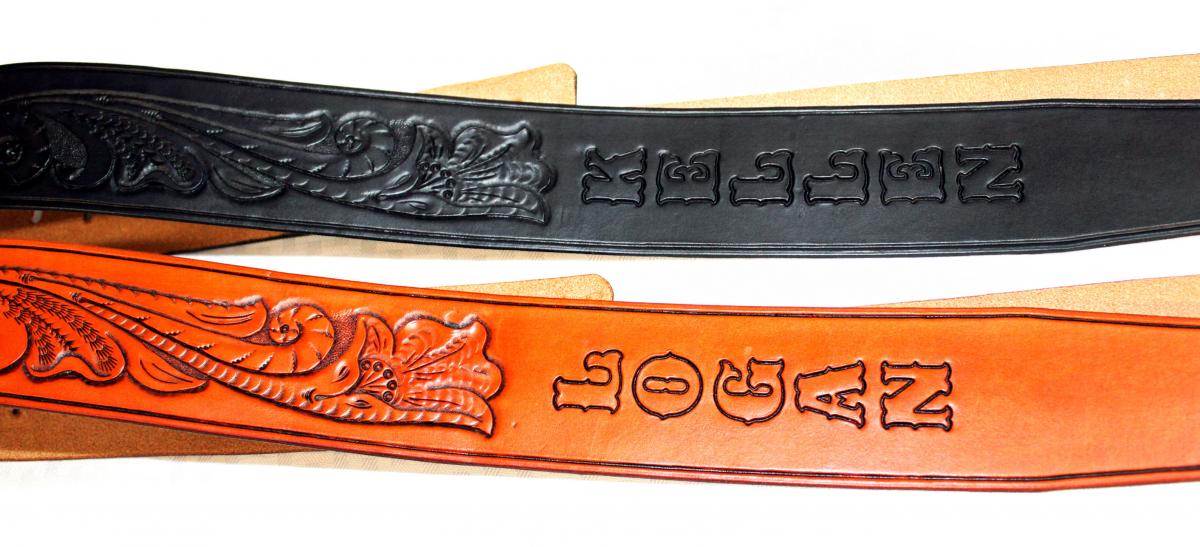

Off the bench last week, Three Guitar Straps, a Banjo Strap, a Mandolin Strap for a F-Style Mandolin, and two 44" Rifle Slings all from Hermann Oak ©, the mandolin strap is from 4/5 oz, the Guitar and Banjo straps is from 7/8 oz and the Rifle Slings are from 9/10 oz. Mandolin players normally like a very light weight strap, the instrument itself is light. The first guitar strap has a carving of Hank Williams Sr., this guys wife says he's a real Hank Sr. fan, never carved Hank before, not completely satisfied with the carving, but she seemed to like it.
