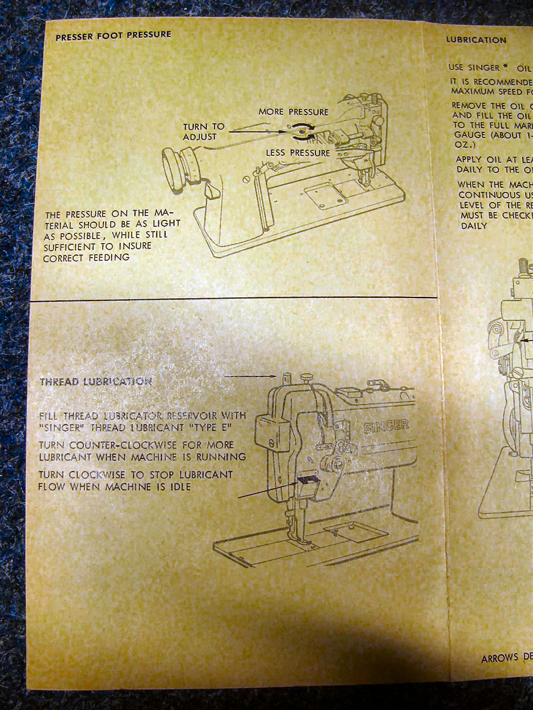

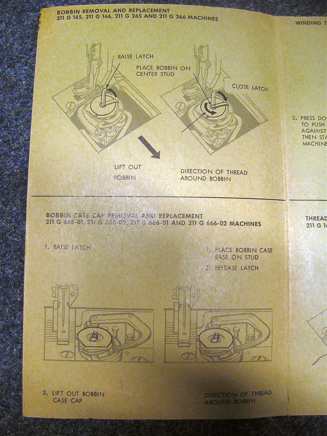

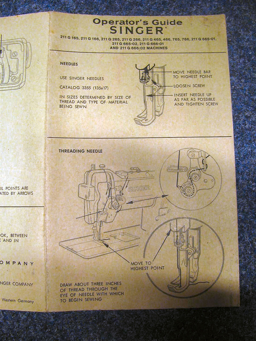

The 211G466 is a large hook machine afaik meaning it is using bobbins with 60% more thread capacity compared with the the standard bobbins. Your machine is made in Germany by the way.
I have some original paperwork incl. the original Operators Guider that came with the 211G machines. I will scan it and post a PDF file here or in an extra thread. I have not much time atm so here are some quick pictures first - hope this helps a little bit.
I will scan the guide in the days to come.
