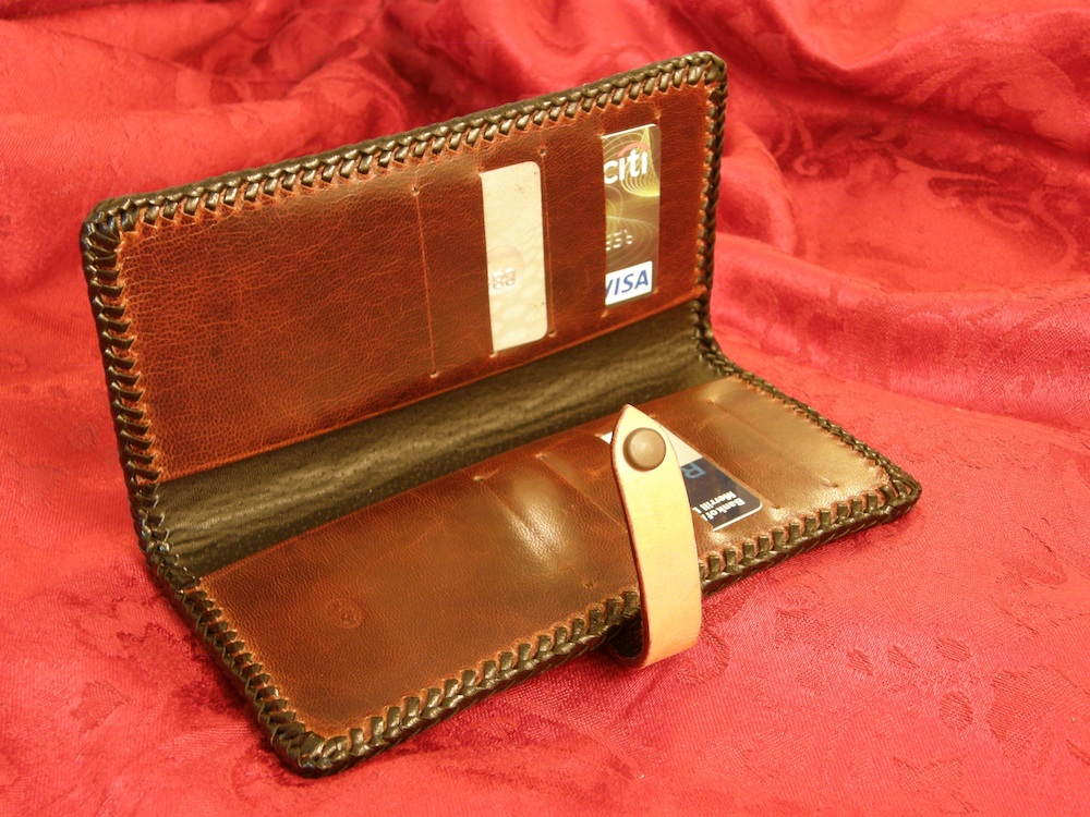

Here's something else I just finished recently. It's a clutch wallet with a stamped fern design on the front and a geometric design on the back. The edges are triple loop dark brown calf lace and the interior is a thin glazed goat skin. There are five credit card pockets on each side, each pocket can easily hold three cards, and under the card pockets there are pockets to hold bills, notes, etc. The lining behind the card pockets is black pigskin.
post-15714-0-27608600-1448467402_thumb.jpost-15714-0-17244500-1448467418_thumb.jpost-15714-0-78348300-1448467447_thumb.jpost-15714-0-55635900-1448467477_thumb.j
Any comments or critique are welcome!

very cool! how do the cards keep from falling down inside?
Sorry it took a while to get back to you. Been away from my computer. Try this thread: http://leatherworker.net/forum/index.php?showtopic=60483
It covers a lot of information about this type of pocket.
