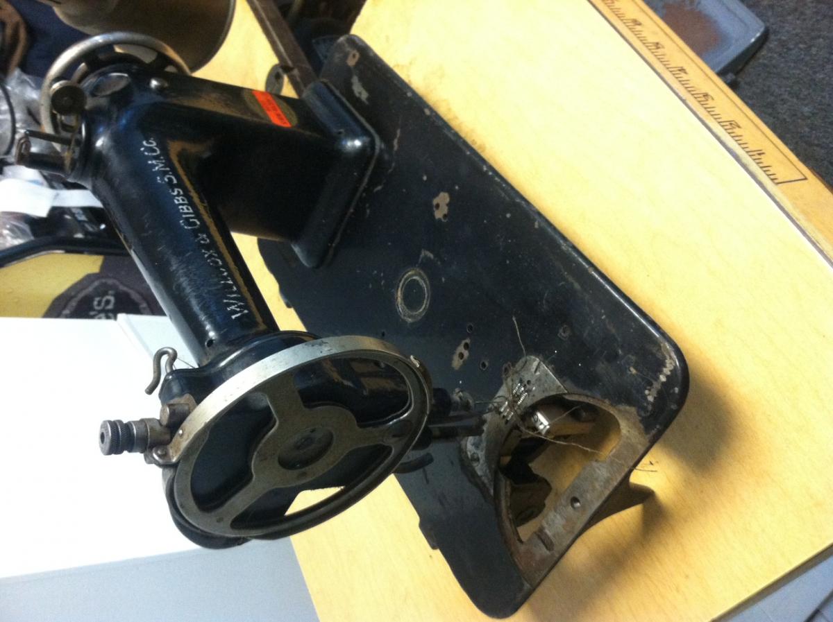

Members MoMatt Posted December 12, 2015 Members Report Posted December 12, 2015 Hello, wondering what model this machine on the local craigslist is, the price is down to 250 obo. I want to try my hand at shoes, and don't want to hand Stich the uppers. Based on what I read I'm looking for something with a roller foot and that can slow down. Another option for sale locally is a singer 241-13 walking foot with no reverse. Would that be a suitable machine for vamps? Thanks Matt Quote
Moderator Wizcrafts Posted December 12, 2015 Moderator Report Posted December 12, 2015 I can't ID that machine from the photo. You would be smart to take some of the shoe upper leather with you and see if the machine can hold it down, feed it without binding, use #69 bonded thread and sew slowly. If you see a glass oil bubble, it indicates that this is a high speed self oiled machine with a pump. It is supposed to run at several thousand rpm to distribute the oil. The 243 is definitely a very high speed machine, made to run at over 4000 stitches per minute. Quote Posted IMHO, by Wiz My current crop of sewing machines: Cowboy CB4500, Singer 107w3, Singer 139w109, Singer 168G101, Singer 29k71, Singer 31-15, Singer 111w103, Singer 211G156, Adler 30-7 on power stand, Techsew 2700, Fortuna power skiver and a Pfaff 4 thread 2 needle serger.

Members Darren Brosowski Posted December 13, 2015 Members Report Posted December 13, 2015 Straight sewer with the most rediculus take up lever system EVER Quote

Members Gregg From Keystone Sewing Posted December 15, 2015 Members Report Posted December 15, 2015 Singer 400W class, rotary take-up, pain in the butt, we threw away many of these long ago when we last had a dumpster at our building. Quote Industrial sewing and cutting, parts sales and service, family owned since 1977, Philadelphia, Pennsylvania USA, 215/922.6900 info@keysew.com www.keysew.com
Cobra Steve Posted December 15, 2015 Report Posted December 15, 2015 Gregg, but the 400W was one of the smoothest running machines around, at the time because of the rotary take up and the ball bearing hand wheel. Quote Thank You Steve Tayrien Leather Machine Co., Inc. 2141 E. Philadelphia St. Unit "U" Ontario, California 91761 1-866-962-9880 http://www.leathermachineco.com cobra@leathermachineco.com

Members Darren Brosowski Posted December 16, 2015 Members Report Posted December 16, 2015 Until they started to play up........ A good one - and I have had a couple - is very smoothe and I have set a couple up with 180W domestic motors.When they start to grab and play up they are scrap. Gregg, but the 400W was one of the smoothest running machines around, at the time because of the rotary take up and the ball bearing hand wheel. Quote
Members Gregg From Keystone Sewing Posted December 16, 2015 Members Report Posted December 16, 2015 Gregg, but the 400W was one of the smoothest running machines around, at the time because of the rotary take up and the ball bearing hand wheel. Ahhh, the ball bearing trick, higher speed, higher performance... Kindly of like all the burned out 143Ws that were supposed to perform better than the 107Ws, that never really seemed to. Quote Industrial sewing and cutting, parts sales and service, family owned since 1977, Philadelphia, Pennsylvania USA, 215/922.6900 info@keysew.com www.keysew.com
CowboyBob Posted December 16, 2015 Report Posted December 16, 2015 Wilcox & Gibbs had them & since Singer was never one to be outdone, they probably copied them so they could bid against them for the garment industry? Quote Bob Kovar Toledo Industrial Sewing Machine Sales Ltd. 3631 Marine Rd Toledo,Ohio 43609 1-866-362-7397
